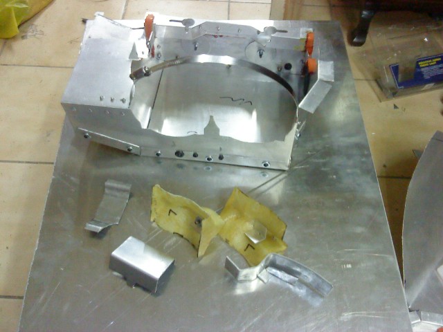

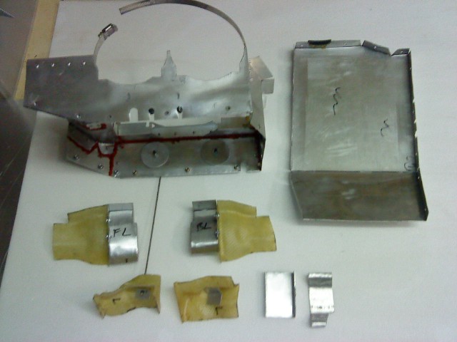

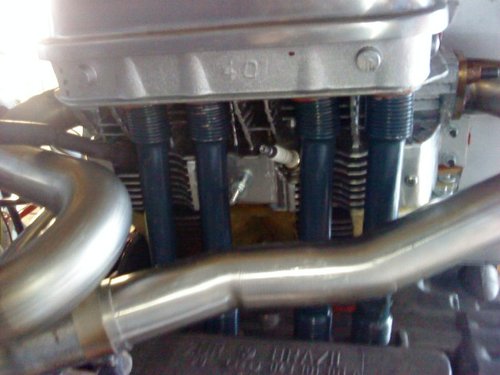

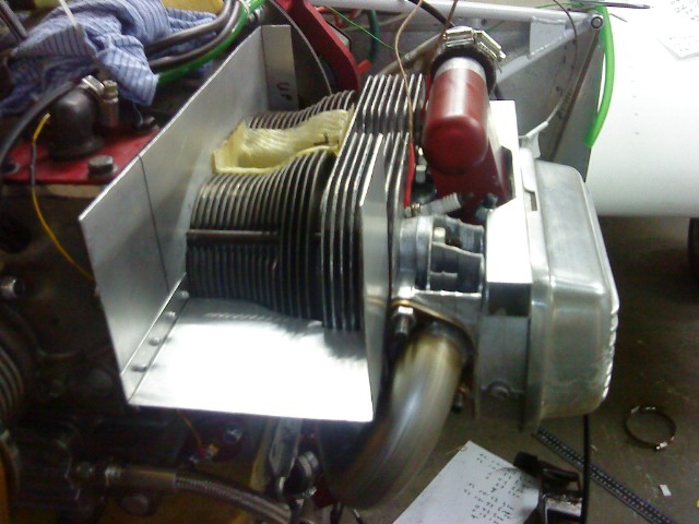

Still slogging along. Regretting my decision to make my own baffles rather than use the Sonex templates and super-tins. In the end, mine will probably (they damn well better!) cool a lot better, but the amount of effort is horrible.
Here is a small sampling of the bits of baffle for one side of the engine:
The picture is missing the bottom edge baffles. The cylinder baffles are finished, but the cylinder head baffles are giving me grief. Should have made and fitted them before fitting the heads to the engine...

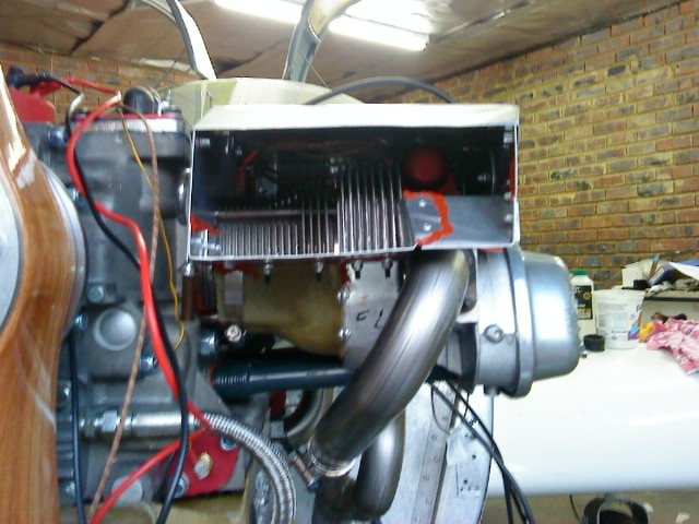

The final set of baffles (1 side shown):
Air does not leave the plenum without passing between 2 fins, or through controlled gaps around the exhaust ports (hottest part of the heads).
After all this work, I really hope this works as expected!

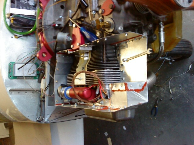

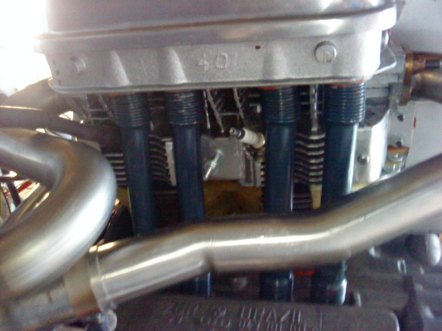

As usual, I didn't quite get as far as I wanted. Was planning on doing high power runs and tuning today - but got bogged down installing those %^&*( baffles. Which idiot decided to build them???
The results of the days labor:
Top View: Bottom View: Bad photo, but if you look carefully, you can see how much of the bottom of the head is baffled. Every mm^2 of fin area is exposed to flowing air from the baffles...
And a front view, with the plenum top on: The sides do straighten up, once the screws are in...

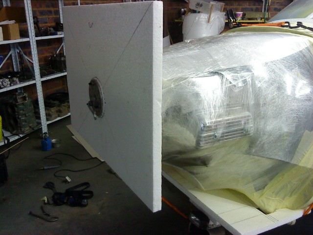

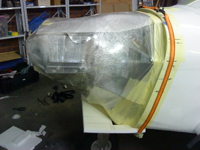

Made a good start at the cowling so far.
First, made a few fillers to block off the bigger chunks of dead space, then wrapped the whole thing in a lot of clingwrap. The lots of masking tape to close off the edges. Then some more cling wrap, and some more masking tape for good measure. If this leaks, I am going to be in deep doo-doo... Should really have removed most of the fwf stuff first to be safe - but I am too lazy
Next, a few polystyrene sheets, marked, waxed and carefully positioned to give the reference surfaces.
Then I added some corex panels for the rest, and my cellphone battery went flat, so no more pics.
Unfortunately, I completely misjudged the amount of foam required, so I only managed to fill the mold about half way. I hope they are open on Tuesday, so that I can buy more.
With the mold framework held in place with a variety of clamps, straps and jacks, I can't really do much on the rest of the plane until this is done - so I suppose I get to take a little holiday now

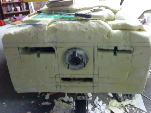

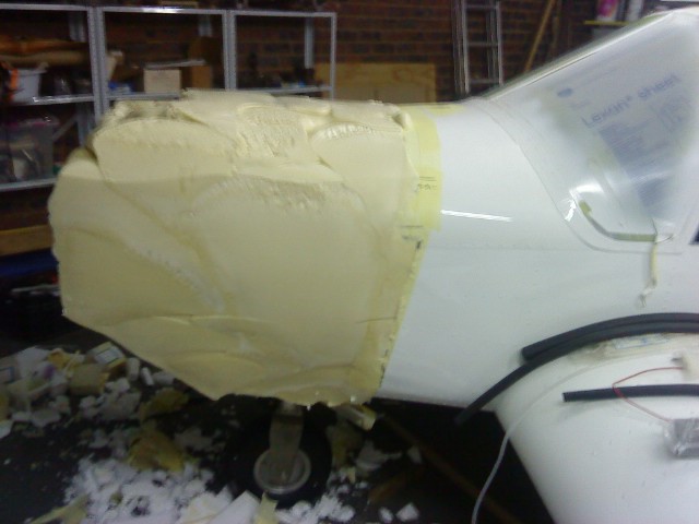

Plastocure was open this morning (fortunately) - so I got some more PU foam. Filled the mold after work, and peeled it:
Next, start cutting out the air inlets - these will eventually fix the shape of the nose of the cowl:
Tomorrow, lots more cutting and sanding...
Re: Justin's Raven
Strongs mate, go do it somewhere remote. It becomes VERY messy, and it goes in EVERYWHERE when you start sanding! Wear goggles, for let me tell you, NOT nice when you get some blown into your eyes.
Note my carving tool. Very handy for determining the initial shape. Just be carefull, that you do not end up with half a VW. Whatever: Let the creative juices flow!!

Thanks Boet. Just finished re-reading your email before making the next assault on the workshop... Lots of good info in there!Boet wrote:Strongs mate, go do it somewhere remote. It becomes VERY messy, and it goes in EVERYWHERE when you start sanding! Wear goggles, for let me tell you, NOT nice when you get some blown into your eyes.Note my carving tool. Very handy for determining the initial shape. Just be carefull, that you do not end up with half a VW. Whatever: Let the creative juices flow!!
Now where the hell did he get to be so clever?
Unfortunately, it takes two hands to maneuver the plane out of the garage, and all my friends have decided that this is a great time to go on holiday! So I will just have to keep working there, and clean the mess up later...
