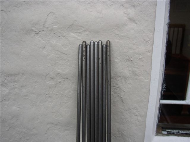

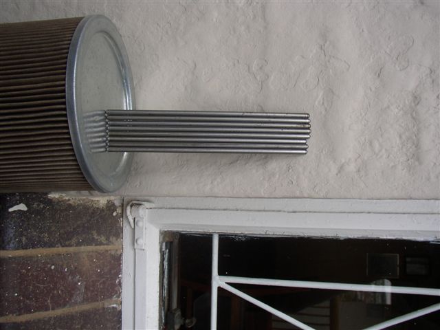

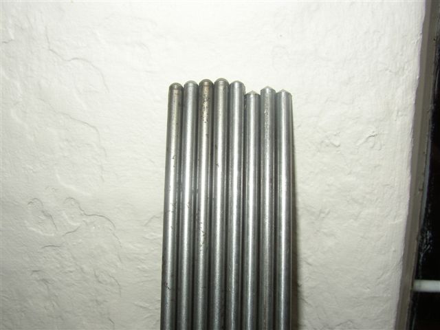

Our AP and AMO visited on Saturday. On Jabirus intsructions he opened one of the Rockers, and removed both Pushrods.
One found to be about 6 mm shorter than the other, very obviously worn down. Opened the oil filter, and found plenty of metal filings and bits and pieces.
Jab now mutter something about a bad batch of pushrods, which never had the points hardened. Waiting to speak to them about replacement parts, labour costs, guarantees etc.
What if I was dead, with a broken Engine? :evil: :(> :(

Ok, so this is what Push Rods shouldnt look like, especialy after 9 hours of flying!!!
The good news is that she should be airbourne again today!
LM
