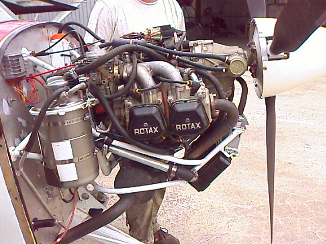

Stay away from aluminium on anything that even remotely vibrates, It will fail
Re: Tailspin's VP-1 Project & Sun Bird Deviation
Postby Tailspin » Mon Nov 09, 2009 12:17 pm
I am seeing that and replacing many brackets.
And the Aircraft has only done 80 Hours. (**) (**)
Postby Morph » Mon Nov 09, 2009 12:20 pm

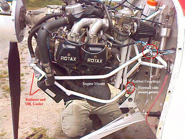

I replaced my radiator and oil cooler brackets with steel tubing at a slight weight disadvantage. Well worth it, done 50 hours since and not a single fracture.
Also moved the mount point off the engine on to the airframe, to reduce vibration there as well
Postby Tailspin » Mon Nov 09, 2009 12:24 pm
If you get a chance take a pic or two, I would like to see what they look like.
Postby Morph » Mon Nov 09, 2009 3:35 pm
here you go, unfortunately taken with a cell phone. The Engine is attached to a large o-shaped mount. This mount is connected to the firewall side engine mount via rubber couplings and bolts. All the engine vibrations are absorbed by these rubber mounts. The Radiator and oil cooler are supported by a frame that surrounds the engine (but does not touch it, and attaches to the firewall side of the engine mount using hose clamps
Postby Tailspin » Tue Nov 10, 2009 7:38 am
Thanks Morph
Will look at changing location and also the materials that hold it.

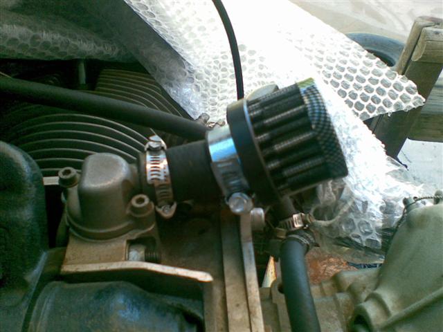

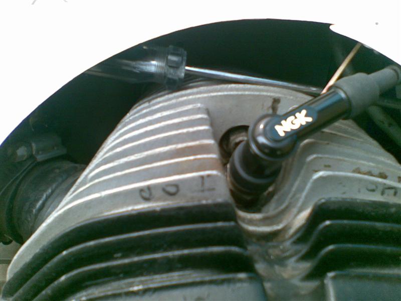

Forgot to add the Pic of the Breather i replaced a normal plastic pipe hanging off the side to a filtered breather.
Breather for Motor

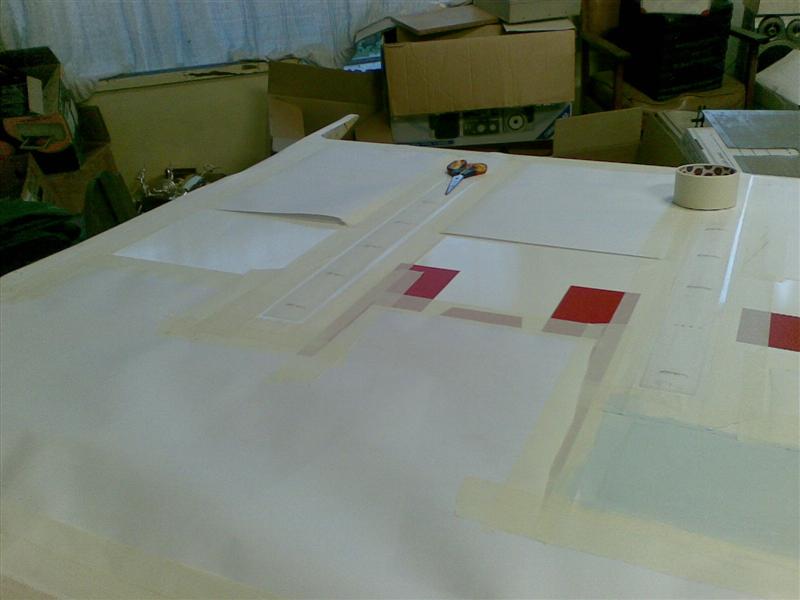

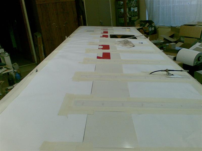

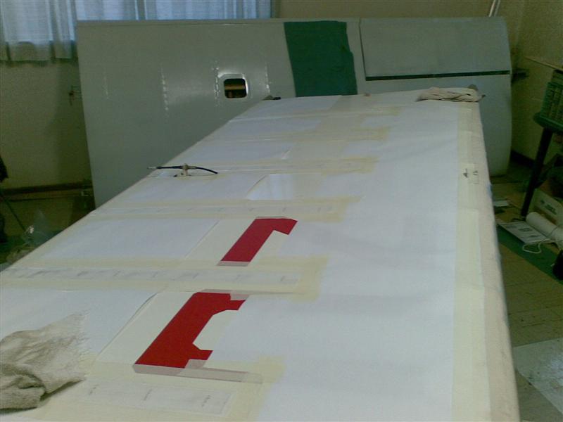

Masking off the wing to get ready to spray. [0* [0* Hate this part (Sorry cell phone Pic's)
Now just looking for a break in the WX so i can get her finished.

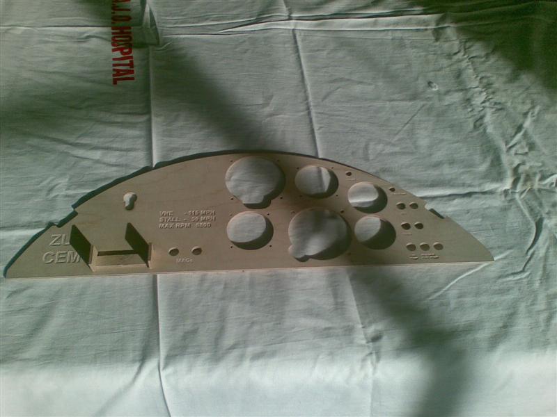

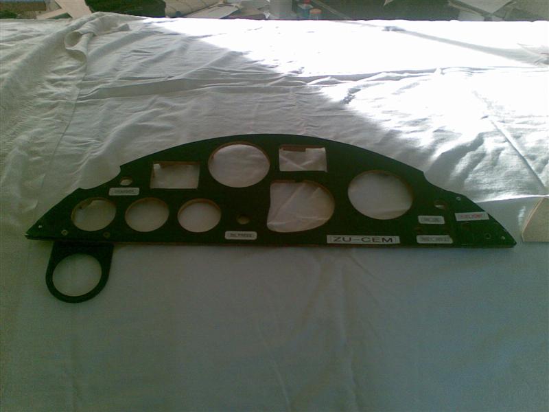

The Final Dash was collected - not 100% finished but enough to test and fit all the thingys and then it will be Varnished and finished off.
the Original Dash.
The New Dash needs to be finished - Now it is just final fitting and making sure all fits and is perfect.
The New Dash
It is coming together SLOWLY ## ##

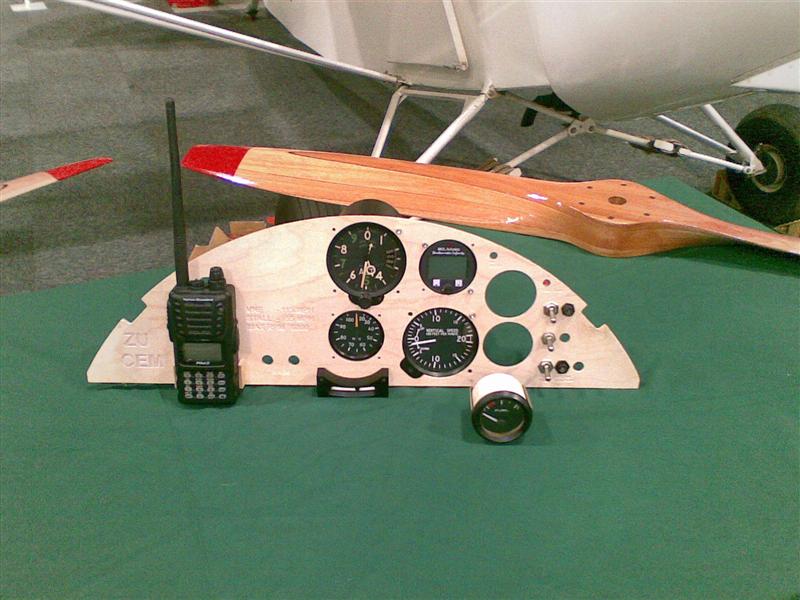

And the Dash with some instruments in.
