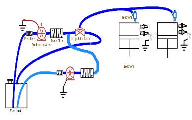

About the fuel system I can confirm that the fuel will not flow back through the fuel pump if it is not switched on. If does not have a non return valve but if you cut it open you will see that it is mechanically impossible for the fuel to flow if the pump is not running (maybe there are different designs ?).
I have attached an image of how I would connect the fuel system with 2 pumps based on how we connect the BMW duel system. The system have 2 pickups from the tank with their own pre-filter pump and main filter each. We think that it is very important to have 2 sets of filters because they do block, in fact on Oupa-G's first BMW engine the filter blocked after about 10 hours and he had to land on the beach (but that is another story).
I think that everybody is as exited as you about this.

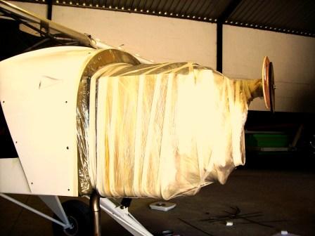

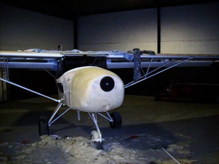

Being mummified today ,ready to pour foam.
Boet kyk na haar lyne en maak daai boesman saag skerp

Who said building aeroplanes was easy?I wonder why they call it glad wrap, because you are glad when you have finished working with it.
Boet ek het al jou instruksies nagekom en is nou reg om die foam te gooi maar ek is bekommerd.Jy sien toe ek nog jonk was het my ouma n winkel gehad {general dealer} en in die winkel het sy onder andere foto verhaal boeke verkoop,ons kinders mag nie die boekies gelees het nie want suster Tereasa van saal 10 het te veel been gewys .Om by die punt te kom Ruiter in swart was my gunsteling.
Ben Brand stap die kroeg binne en bestel n glas melk die dorp se skobbejak vererg hom en pluk sy revolver uit maar dis te laat BenBrand se revolver blaf twee keer BLAF BLAF.Ben spring op sy getroue swart perd Duiwel en ry in die sons ondergan in ,die aanvalige meisie ,duidelik verlief,staar hom agterna en dink by haarself,sal ek daardie man ooit weer sien.
Die vraag is na ek nou die foam gegooi het sal ek die yaris enjin ooit weer sien.

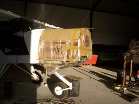

Ready for foam
- chitty chitty bang bang
- 006.JPG (40.44 KiB) Viewed 4752 times
Re: TOYOTA YARIS ENGINE

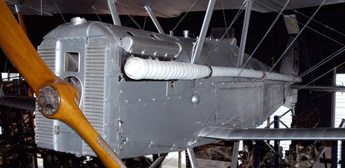

dieseldog, ek lyk daai chitty-chitty-bang-bang vorm van jou errie se neus pap en derms. Laat mens dink ne??
Weelll, dit het goed gewerk vir die SE5A..........en baaaie plek gehad virrie radiators???
Gerald, die vorm wat daar gaan uitkom sal pragtig wees. Let your creative juices flow!! sanding poly-u is a screaming bstd of a kak job. Enjoy!!!!

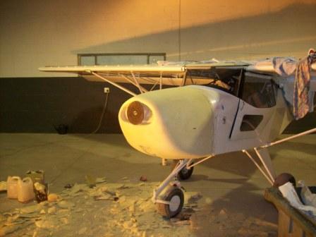

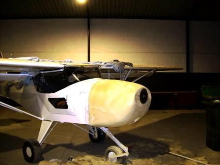

Starting to take shape

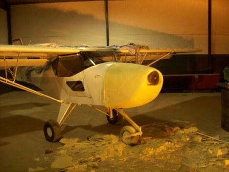

Getting late now must go home ,happy with the cowl plug so far.
- 009.JPG (40.03 KiB) Viewed 4638 times
- 010.JPG (39.87 KiB) Viewed 4636 times
- Low Level
- Posts: 1204
Geeez dieseldog - you get the talkers and the do-ers. No guessing to which clan you belong.
Looking good.
Looking good.
