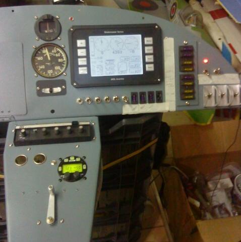

The engine debacle really put a dent in my enthusiasm, but I am back on track now. I have been puttering with the electrics for the past few months. Being an electronic engineer, I thought it would be quick-quick... And I suppose in total man hours it is not too bad - just soooo tedious, it is difficult to get back into the workshop to finish it!
I actually took this photo last night of the completed panel:
All tested and ready to go. Just need to take the completed wiring harnesses and install them in the fuselage. Also need to work on noise suppression on the radio power lines, as I am picking up flourescent light noise - so it will definitely pick up ignition noice.
Once the electrics are out of the way, it is time to sweep, clean, polish, vacuum (lather, rince, repeat) until the workshop is spotless, so that I can start engine assembly again.

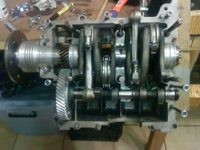

OK - A year and a half after buying a 'good condition, low hour' engine, I am finally on the verge of having a 'new condition, 0 hour engine'... Had to replace/re-machine just about every component, but it is finally comming together again.
This is the result of the first evening:
Everything measured and trial fitted. All clearances, end floats, etc. within new spec, everything flushed and cleaned. Tonight I close up the bottom end, and measure up the top-end geometry.
You can also see the new prop hub in this photo - the hub itself is a taper fit over the crank, and ends flush with the timing gear. It is fully supported over the length of that huge bearing you see at the end there...

OK - I am running out of words to describe the level of incompetence displayed by 'engineers'...
Although I knew that there was no interference (this was a previously running engine, right?), I decided to flip the engine horizontal so the rods could dangle, and I could rotate the crank. Lo and behold - it turns 90 degrees, and locks solid. Wiggle all the rods - they all move, so none of them are jammed. Fiddle prod, poke, take the cam shaft out - and it turns. Cam back in, and it doesn't turn - but the rods definitely aren't near it. Must be the gears, right?
Inspect the aluminium cam gear, and find a small gouge near the back edge. Hmmm.. . Have a look at the brass gear, and the very end of some teeth are bent - squashed in from the back face. Yup - some kind soul at one of the engineering shops thought it would be a great idea to remove a (relatively soft) brass timing gear with a hammer...
Tomorrow night is me and a dremel tool, to see if I can clear the burs, otherwise it is time to strip the crank. Again.

Managed to clean up the gear, but even though I taped up #3 bearing, I managed to get some dirt in. So time to strip the crank again and fit a new timing gear.
Hope I can do it without an engineering shop, or it is early holidays for me (until the engineers re-open).
