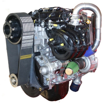

120HP ECOYOTA YARIS WITH ROTREX SUPERCHARGER
ENGINE RESIZE.jpg (69.7 KiB) Viewed 5212 times
This engine was tested for 3hrs in a destructive dyno run at a power setting of 132hp . After which it was disassembled and inspected all internal components, found to be with in OEM specs and no signs of abnormal wear was found.All parameters eg, oil press, oil temp, coolant temp and egts kept normal by tuning with the ECU.I will like to duplicate this test with Boets yaris if he agrees :lol: :lol: :lol:

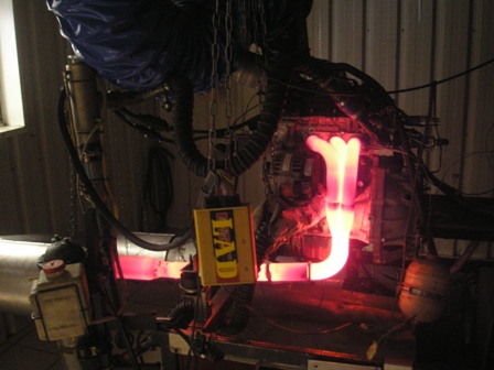

yaris on treadmill
turbo-nuit_1 resize.jpg (83.81 KiB) Viewed 5212 times

Postby Boet » Thu Feb 18, 2010 10:45 pm
:shock: Eeeish, now you have ruined the friendship. :evil: Go ahead anyway, bugger it up, just give me new one in exchange!! :lol: :lol: :lol: :lol:
