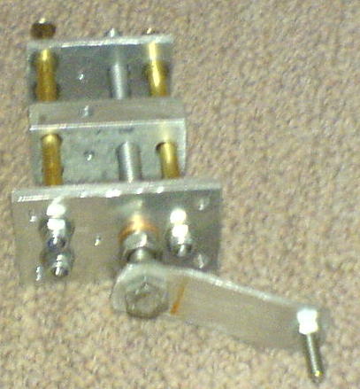

Also made attempt #2 at a trim control. I would like to move the trim control to the center console, so that it can be used from both seats. I really like the crank handle use in the Piper Tri-Pacer, so I tried something similar here. Unfortunately, I could not find lead screws anywhere, so I used a stock metric thread. That means you have to spin the crank 50 times to go from full down to full up! Actually not a major issue, as the trim stays near the middle most times anyway. If I can find a proper leadscrew though, I will use that.
The trim cable goes right through the middle of everything, and gets clamped in the center piece. Still need to add steel cable guides to the top and bottom plates.

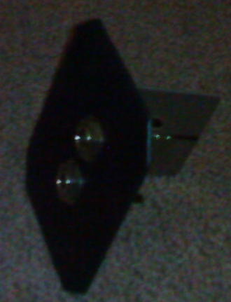

Nylon mounting plate for headset jacks. A simple nylon sheet, backed with an aluminium L for a local ground, as well as cable support. The nylon plate gets bolted into a hole in the baggage compartment floor, and isolates the jacks from the fuselage, to prevent ground loops.

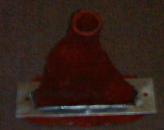

'Rubber' boots for the nose wheel steering push rods. This is an interesting composite that I had never heard of before reading about it in Kitplanes. Basically take some heavy fiberglass cloth, and thoroughly rub red (high temperature) silicon in (until the back side of the cloth is thoroughly wetted). Then lay it over a bold, with a decent overlap.
Once it cures, you end up with a very flexible, incredibly tough 'rubber' boot.
I initially made the mold too short (misjudged how close the end fittings come to the firewall, so I had to add an extension to the top. Looks ugly, but won't be visible ;-) .

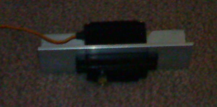

And the servo mount. The third iteration thereof. Difficult to make something that can take 5kg of force pushing on the servo, and distribute it evenly through the base plate, but still provide vibration isolation. This one seems to do the job, although it needs more testing.

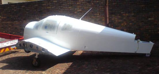

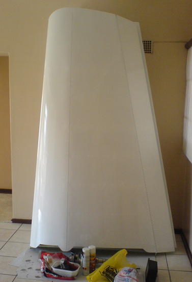

Got the plane back from Skyworx on Saturday, and it is beauuuuuutiful :D . Solid white for now, but a friend will airbrush some designs once it is flying.
The paint makes an amazing difference. Changes a somewhat industrial looking chunk of aluminium, into a sleek and shining aircraft. And the interior makes me drool. Can't wait to get it flying!

justin.schoeman wrote:Got the plane back from Skyworx on Saturday, and it is beauuuuuutiful :D
Justin, I passed you on the Krugersdorp highway on Saturday morning towing your new baby - looked great - enjoy!

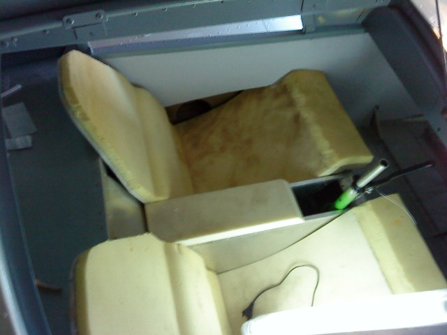

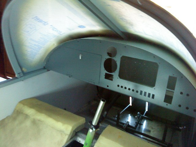

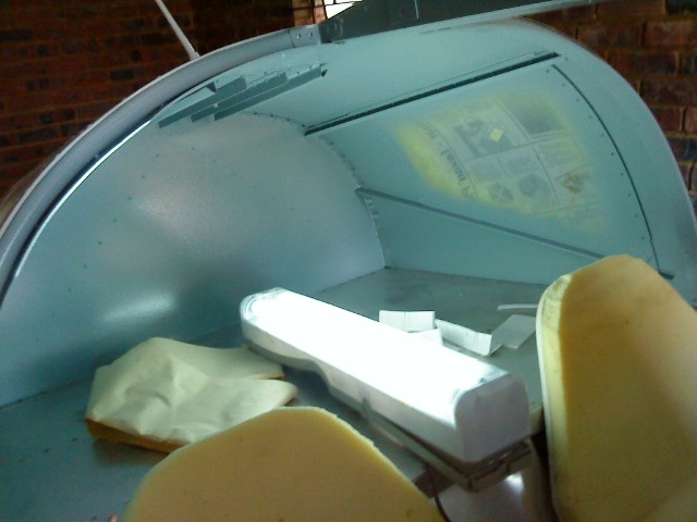

Some interior photos... Spent the weekend preparing templates for the side panels, carpets and fabric. Also finished the foam for the seats (excuse the dirty footprints...).
Once I have treated all the foam and fabrics with flame retardant, I can put it all together, and have a nice pretty interior :D .
[The interior colours are a bit washed out in the photos - it is a bit darker than what the photos look like (especially the panel).]
Luggage shelf
