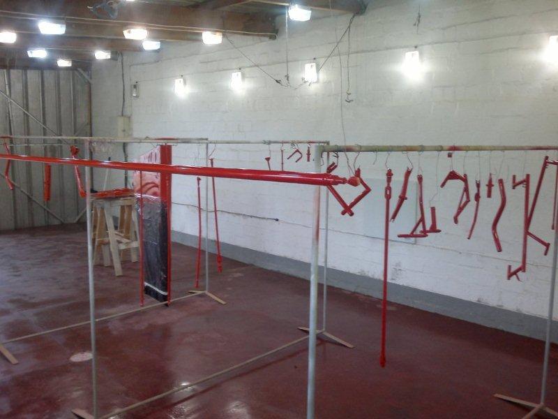

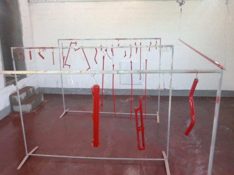

Postby Jean Crous » Sun Aug 24, 2014 9:03 pm
Ok, here are 2 pics of all the controls and other small bits painted red...... the frame will follow shortly. I have been thinking to do the frame in a light gray colour instead of white.
Jean.

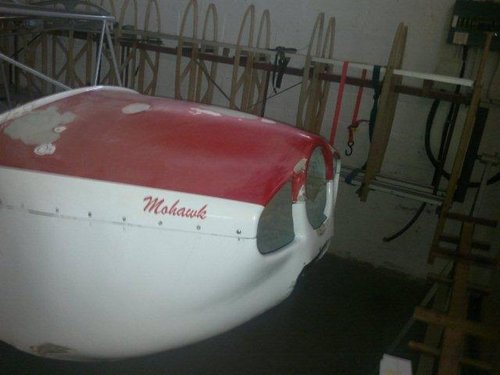

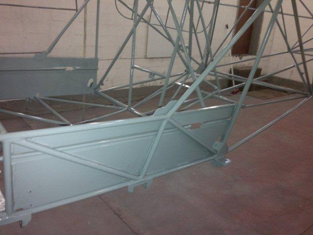

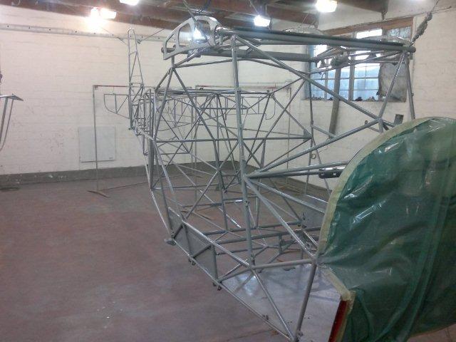

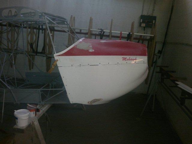

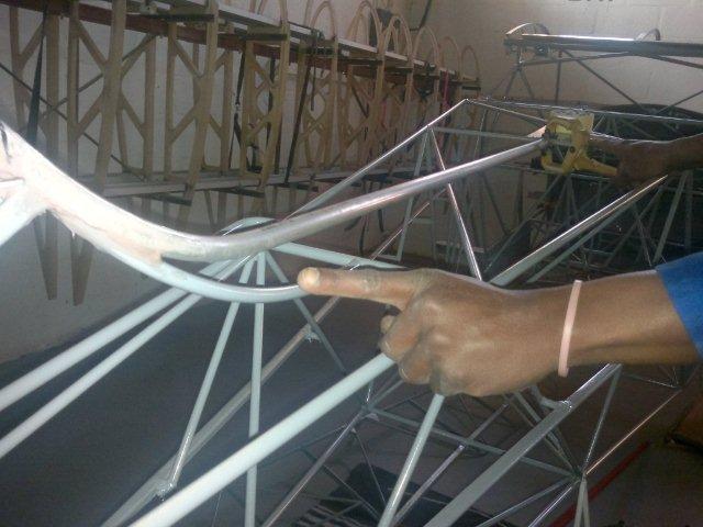

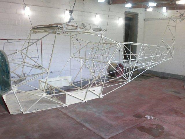

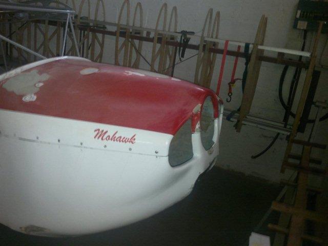

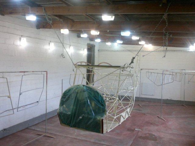

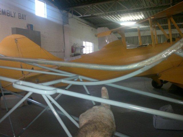

Here are some updated pics of what I am busy with after work hours on the Kitfox. The dorsal area leading to the vertical stabiliser is a bit "flat" on the early Kitfox models so I made a plan with some 6061 alu tubing held in place with Sparbond 340. The cowls were a bit of a conundrum, the early Kitfox one could have with the "Round Cowls" or the conventional cowls, of which I had no sample. Next best thing...........I am rebuilding a Mohawk (Avid copy) for a friend, his cowls are a nice shape but in badly cracked form, ssssssoooooo.....make a plug out of them , draw a mold, and make new ones.... :mrgreen: :mrgreen: and a set for the Foxie vhpy
More updates to follow as we progress.

Kitfox frame neatly sanded before painting
before painting
after grey paint job
close-up of frame after paint
Dorsal fin mod
close-up of dorsal mod
Mohawk/Avid cowls
Another cowl pic

Postby Goose » Thu Sep 04, 2014 7:42 pm
Daai cowl sal die een anders laat lyk (^^)
Posts: 1262
Re: Kitfox no:649
Postby Jean Crous » Thu Sep 04, 2014 7:44 pm
Ja , hierdie cowl laat mens toe om die 582 regop te installeer.
J

JeanTree wrote:Ja , hierdie cowl laat mens toe om die 582 regop te installeer.
J
My Kitfox2 se 582 was regop en hy het radial cowl gehaat. Ek sien sy is nou in Zim.

Postby Jean Crous » Thu Sep 04, 2014 9:02 pm
Ek het die ronde cowls saam gekry, maar die onderste deel was bietjie versnipper :lol: Hierdie cowls in die foto is van n Mohawk waar die enjin onderste bo gemonteer moet word, ek het destyds op hulle so n bietjie "snykunde" toegepas sodat die 582 regop kan wees. Daarom het ek gedink dit sal mooi werk op die Foxie.
