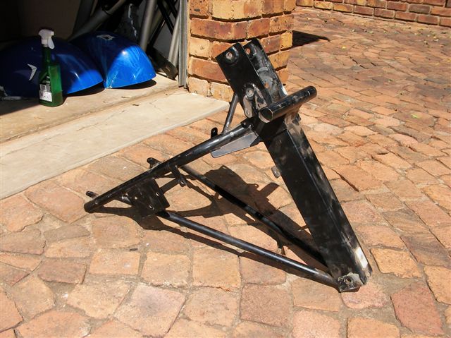

Postby Bundy » Sun Apr 15, 2012 12:40 pm

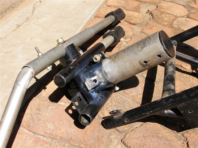

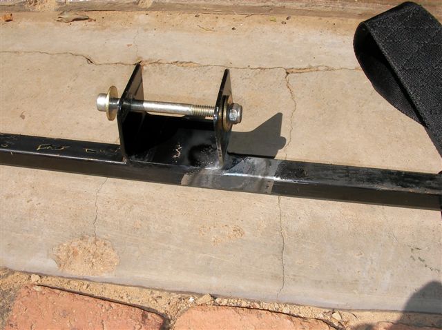

Fuel Tank Bracket, straightened and re welded...needs some paint and done (^^)
Meet our "new" engine frame. Off to the Powdercoaters with you! :lol:
In the impact, the Starboard side of this seatframe bracket sustained damage where the drab strut connects to it via the rose joint. Cut off and re welded into position, also awaiting powdercoating. (^^)

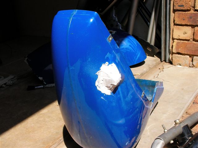

Amazingly, this was the only damage to the Banana Pod. (Pitot tube broke off). Fibre glass repair complete, body putty applied and just needs a little elbow grease and sand paper and will have this and the Pylon Fairing re sprayed. (^^)

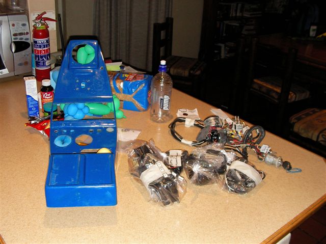

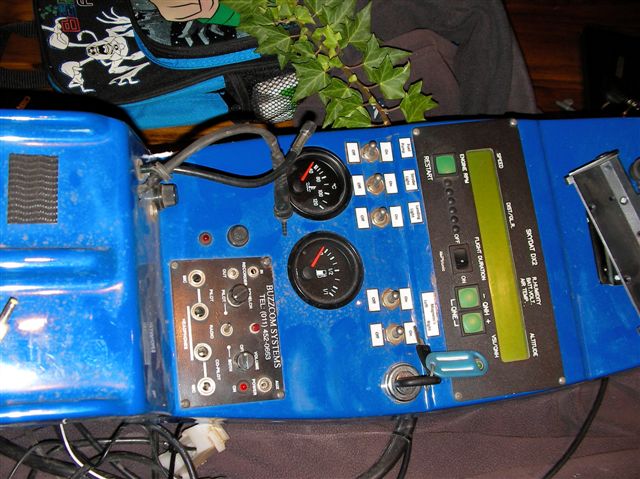

Stripped all the instruments out of the pod tonight...
Pod Before:
Pod after....ready for sanding and paint prep (^^)
Although I packaged and labelled everything extensively.... I hope I can remember where all this crap goes! :lol: :lol:

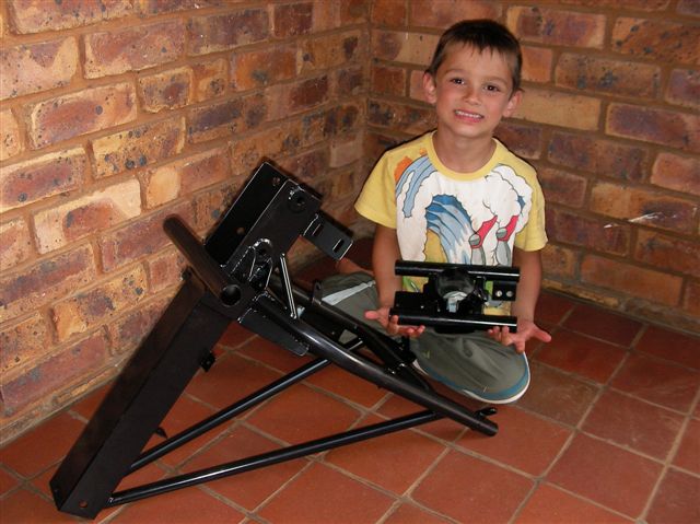

My son....AP in training! Screw the car, gonna have to buy him a plane in a few years (^^)
Frame and various other bits back from the Powdercoaters. :)
I got excellent service and prices from NPA Powder coaters in Silverton. I can honestly recommend them... 8)
