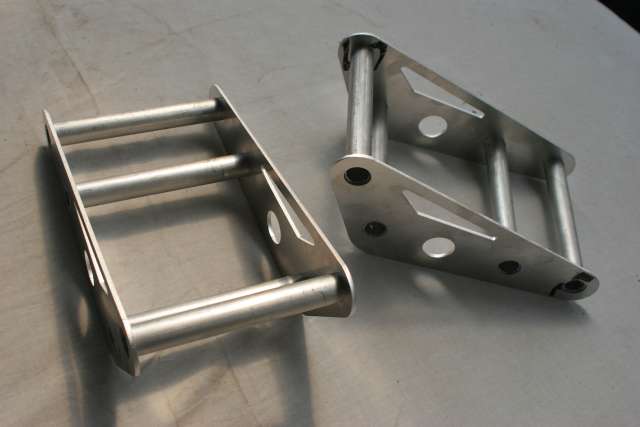

I have also assembled the first parts (not welded). I would have liked to do some work this weekend but I am having trouble with getting the stainless steel. The place I have ordered it from only wants to supply me with 6m lengths. I will therefore order it from somewhere else but that will only happen next week.
Fist assembled part: foot pedals

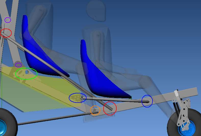

Today I will discuss the frame and explain my ideas around it. As usual feel free to disagree.
The frame is used mainly to mount all the other stuff on. You do not really have a choice what you are going to mount on it, just where and how. Furthermore it must be strong enough to carry all the weight.
The main part of the frame consists of 2 rectangular stainless steel tubes of 80x40x1,5mm joint at an angle of about 140 deg. An upright that serves a engine mounting is welded to the back of this.
To strengthen this frame, 2 tubes runs from the engine mounting's top (red oval) to the bottom (red circle) Note the important function of these tubes on most trikes: with the engine 'hanging' on one end and pilot in command 'hanging' on the other end of this frame it takes most of the strain of the frame. This also forms a frame around the passenger. (On most trikes the this these tubes run from the red oval to the orange circle. The bottom mounting point was moved forward in this design to 'carry' more of the forward weight and to leave more space for the fuel tank.)
The front part is strengthened as well with 2 tubes running from the blue circle to the blue oval. These 2 tubes have the additional function as mounting points for the front seat. The front seat is easily adjustable by sliding the front seat on these to tubes.

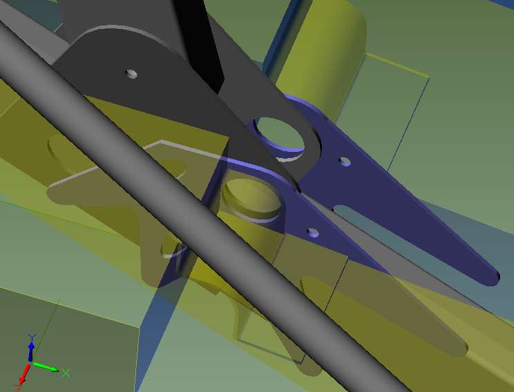

In contrast to most other trike designs, the tank hangs underneath the frame in this design (same as the DTA). Hanging the tank is a bit tricky. In the old DTA's there is a pipe running from the one side of the tank to the other on which the tank hangs in rubber mounts. This is difficult to manufacture and difficult to mount. The new DTA's use a plastic tank that is strapped to the frame. I have moved the tank hanging point to the top of the tank. Two plates welded to the tank act as hanging points. A pipe of about 35mm aligned with the holes is also welded to both sides of the tank. See detailed drawing with pipes and bolt removed. A rubber of 35mm with a hole for a bolt is inserter into these pipes. Large washers will be added to both ends of the bolt and the bolt tightened. The rubber should expand on compression and give a nice tight fit. The front of the tank will rest on a mounting at the blue oval. As an alternative or as a safety a strap can be used running underneath the tank. Straps that can carry 3 tons are easy to find but would need regular replacement.
Until next time. (^^)
Frame layout
Tank hang point detail
