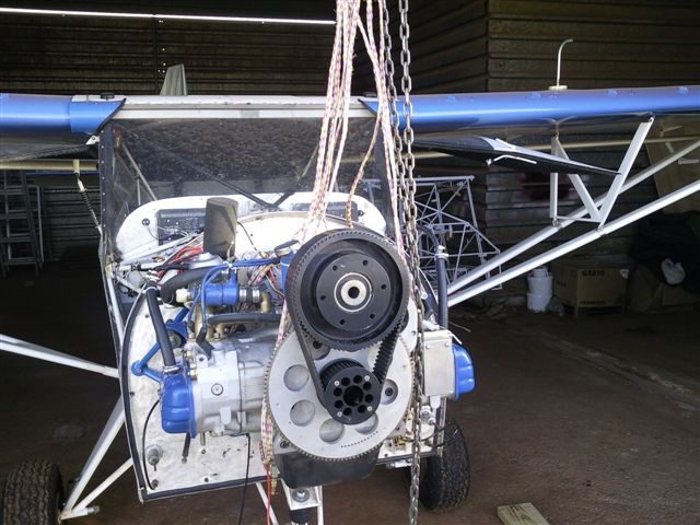

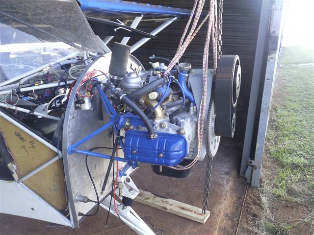

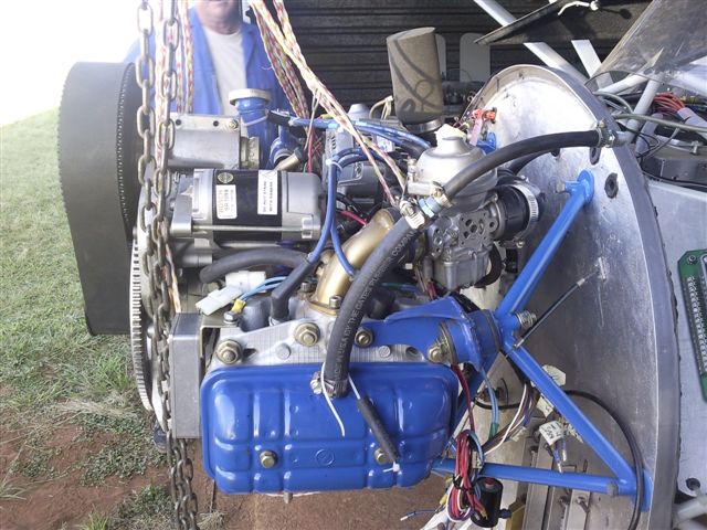

So we have liftoff, the motor is in, C of G looks OK this weekend we will get the exhaust on and the cowl modified. I hope I can get pass from the boss and finish the cowl by Tuesday. Next weekend wiring is on the plan of action and the next weekend test flying....... ** ** OK let a guy dream! I hope to have her flying by end July. This is quite possible but time does not come cheap.
I need to do the following:
engine wiring
new dash
Stratomaster set up
cowl modify to accommodate the belt drive
re-upholster the seats
I know it is a lot of work but a certain Duck will have to pun in some hours too, I knew he was good for something ## (**)
Keep you posted ($$)

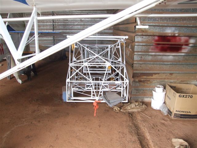

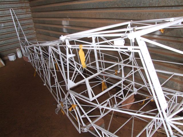

As daai Eend dink dit is baie werk :twisted: :lol: Look at the pics below, what do we have here :?: Could it be a Safari :?: :?: does it still have to be build :?:

Jou thrust-line lyk moer hoog?? As jy daai cowling vir die enjin moet moddifaai, sal hy darem maar eienaardig lyk. :lol: Die enjin moet tenminste 4" sak, om jou thrust line beter te kry, dan sal die cowling ook sommer beter pas??

jy moet ernstig met die ou praat by wie jy die Safari gekoop het. Ek sien daar is nie 'n sn plaat op die raam nie en daar was intussen al 'n paar upgrades op goed soos die legs en liftstruts. As hy nie Sn het nie is daar ook nie certificate of conformance nie en is hy dus nie by ons geweld nie of ons het net 'n gedeelte van hom gedoen.
