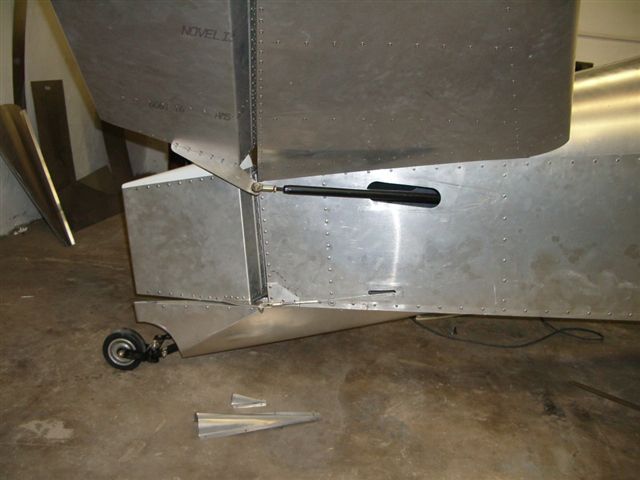

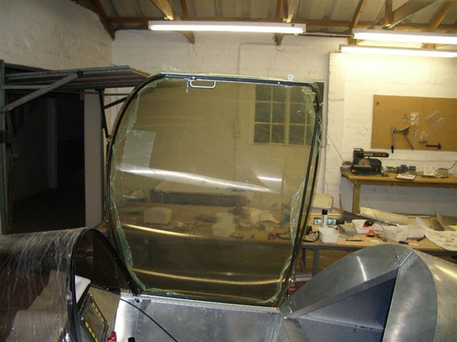

Hertewith the promised pics.
Canopy and cowling just put in place. Spats and fairings still to be fitted, after test flying. Wing fairings need to be riveted, but trying to find a finishing solution.
Very tight connecting flap pusrods, in the wing, had to use riveting rosi's small hands. (**)
Should finish most of the stuff this weekend, should be able to do some test taxing.
Need to check all settings of flaps, ruddervators etc. Install some upholstery. ##
Final Inspection booked for next Sat, then submit docs!!
VERY CLOSE vhpy vhpy vhpy puff
