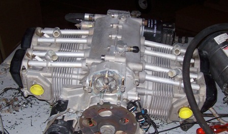

Postby Boet » Mon May 21, 2012 8:34 pm
Hopefully not. The engine is a 912, that has been too near the coast for too long. :( It has some corrosion, so cosmetically it looks shit. :( But then the price compensated, and she runs very sweet. (!!) I got the boereraat to paint the engine with vinegar, to get rid of all the white spots, but that was not very effective. :( A small steel brush seems like a more effective candidate, or bead blasting. :? What do you guys suggest? But I got a very good deal on it, and the engine is complete with a 72" 3-blade Warp drive prop, all radiators, coolers, switches and gadgets to make the prop go round, silently, because silencer system also in the fray. For you oke`s near the coast, spray your engines with a light coat of some sort of penetrant oil, to keep it from rusting. This looks terrible. :shock:

Postby Tailspin » Tue May 22, 2012 1:45 pm
Bead Blasting is best then clean it from there.
Karman
Posts: 96
Joined: Mon Sep 05, 2011 8:51 am
Location: Stellies
Re: Finally: MY own Bushbaby Explorer
Postby Karman » Wed May 23, 2012 9:35 am
maybe try this: Seems cheap enough to try
http://www.aircooledtech.com/tools-on-t ... a_blaster/
L:
Postby Tailspin » Wed May 23, 2012 12:31 pm
Damn
Now this is a Good Idea. s023
Postby Tumbleweed » Wed May 23, 2012 1:40 pm
For a short cut quick valet, spray Zeb oven cleaner and rinse after a few minutes. Caustic??
Karman
Posts: 96
Location: Stellies
Postby Karman » Wed May 23, 2012 1:44 pm
Tumbleweed wrote:For a short cut quick valet, spray Zeb oven cleaner and rinse after a few minutes. Caustic??
carefull on alu ... if i rmember.. caustic soda and alu makes hydrogen ...-> (**)

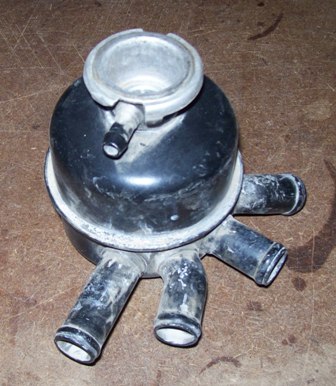

Postby Boet » Wed May 30, 2012 7:57 pm
Engine looks all spiffy after it has been blasted. Now just to put all together again. KFA making up the latest engine mount system for my Baby! Anyone have a spare "spider tank" lying around? This engine still has the old system, loose spider tank and 2 stroke type header tank. I want to de-clutter a bit! ( Like things to be kept VERY simple!) vhpy
Definately looking a LOT more presentable!!
`ol rusty.JPG (59.51 KiB) Viewed 3574 times
Need one of these?
