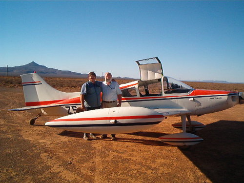

Hi Oupa-G,
If I may ask what is this Vansin, could you post a pic please would love to see it.

That Vansin has really nice lines. If it flies as good as it looks, it must be a great machine!
Almost 3 weeks that I last reported I had been to Namibia what a wonderful trip. I was joined by Ystervark7 who also happens to be my son in law. We had a wonderful time. Just some specs on the Vansin 160 hp Lycoming Turbo-normalised fuel injected running on Mogas. I replaced the valve guides with the High Chrome later Lycoming guides. 35 l/h flying 135kts plus.
On the 1800 nm round trip the average speed was 122kts that included all the circuit work as well as climbs etc. this homebuilt flew for the first time in 1978 and was built by the remarkable Carel van Aswegen. He was well ahead of his time.
I was fortunate to have seen this aircraft from the first rivet to the final finish. When Carel stopped flying in 1992 I became the proud owner. I enclose a foto on the recent trip this is not a complimentary foto she is really this beautiful.
