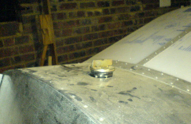

This is my next victim:
Although functional, I find the fuel cap of the Raven particularly unattractive, and aerodynamically, a bit of a disaster.
At the moment I am thinking hard of various possibilities for closing the tank. One option is to drop the tank, use a standard cap, and put a flush panel over the hole. The tank is a little larger than standard though, so dropping it further may make life uncomfortable for long legged pax.
I am leaning towards some (currently fictitious) arrangement where some flush fitting cap seals firmly against the tank, and the fuselage. Probably a fairly thick aluminium plate with a silicon rubber disc stuck to the bottom, and some mechanism to hold it firmly against the filler neck.
Anybody have any ideas/examples of what they have done?

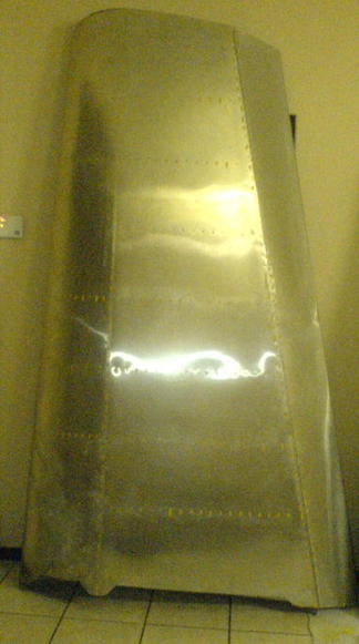

A while ago, someone asked for a pic of the wing:
That is the corner of a standard door (2.1m high) sticking out just behind it... Scarily small wing span here! The base is exactly the same width as an HD wing, if you need more scale.

Postby Wallaby » Thu Aug 27, 2009 7:26 am
Yep, it was me who asked. Thanks Justin. How much faster is your stall speed with this wing? And it looks like around a 7m wingspan that you're going to have. Are there any other Raven planes with this wing flying around? I see that Carl kept with the full span ailerons and there's no flaps. With this short wings you'll have a incredible roll rate. :) :)

Postby justin.schoeman » Thu Aug 27, 2009 9:51 am
Wallaby wrote:Yep, it was me who asked. Thanks Justin. How much faster is your stall speed with this wing? And it looks like around a 7m wingspan that you're going to have. Are there any other Raven planes with this wing flying around? I see that Carl kept with the full span ailerons and there's no flaps. With this short wings you'll have a incredible roll rate. :) :)
I don't think there are any Raven's, but there are a couple of Zodiacs (601HDS) in the country. Never flown the HDS wing myself, but apparently quite sporty ;-) . Stall speed should be around 58mph @ 540kg, or 54mph @ 500kg. I do have VGs that I will install. Tested stall speed in a 601HDS with VGs is 44mph.

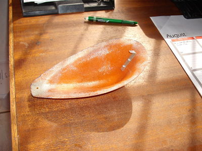

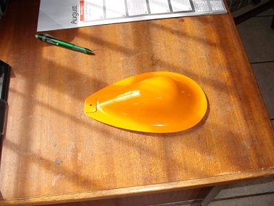

Made this for my XL fuel caps.
cap covers
justin.schoeman
Posts: 1234
Re: Justin's Raven
Postby justin.schoeman » Sun Aug 30, 2009 3:18 pm
doreen wrote:Hi Justin,
That looks good. How do they attach in the front?

Re: Justin's Raven
Postby doreen » Sun Aug 30, 2009 3:29 pm
8mm hole in the skin
