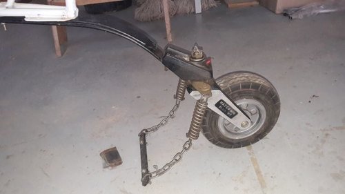

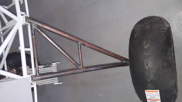

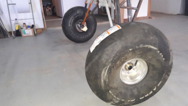

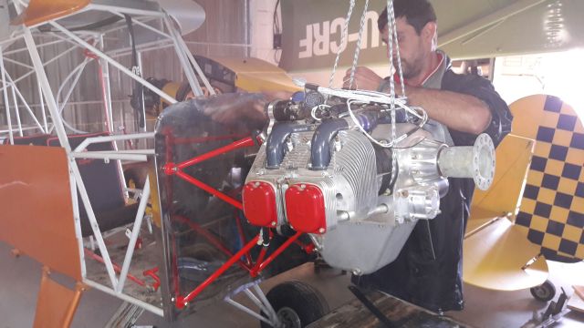

- Posts: 1262
Re: Building the new Cubby Renegade

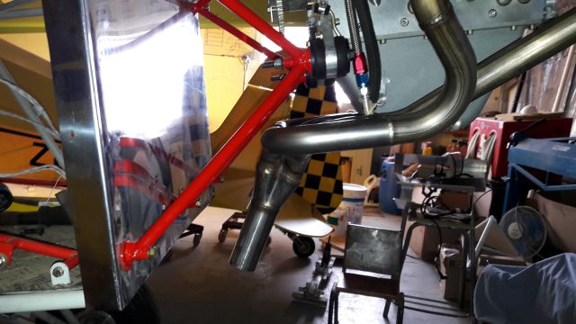

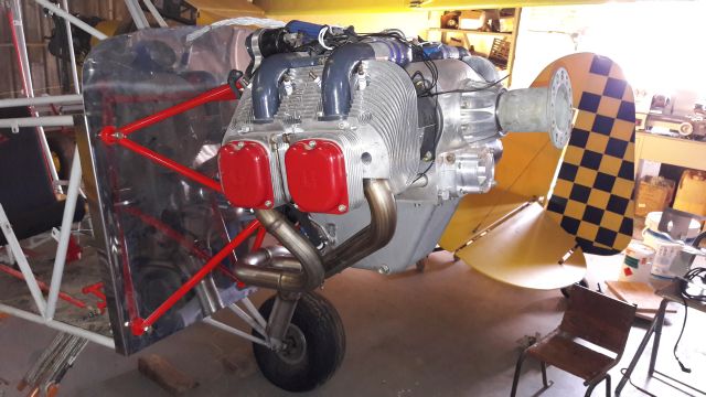

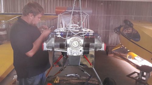

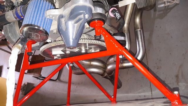

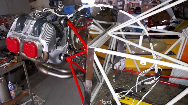

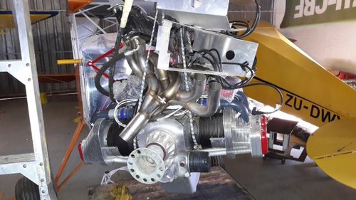

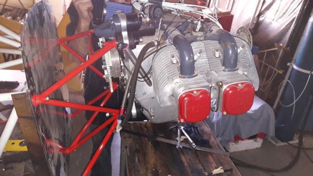

Here are some photos of our recent progress, enjoy ! As mentioned this is the installation of the UL Power 350i engine of 120hp.
Jean.
Jean.

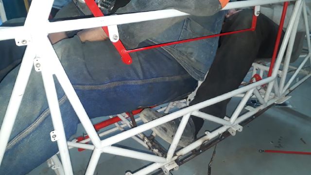

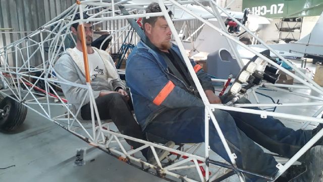

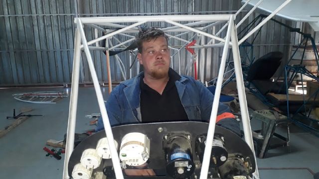

So today we started on a bit of a rework of the rear passenger`s rudder pedals position. This is in order to give a better seat "feel" to the now front seat pilot. As the old Cubby was a rear seat solo aircraft the rear occupant had to have the best seat, so to speak, but now the boot is on the other foot....( or is it Butt on the other seat...) , so the front seat has now got to be the best seat :D Once we are done playing , I will post some photos of our endeavours. The brakes will also be changed from heel-brakes to-toe brakes, with the master cylinders on the front rudder pedals , connected to the toe-brakes.
Jean
Jean
- Posts: 1262

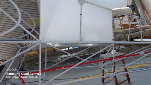

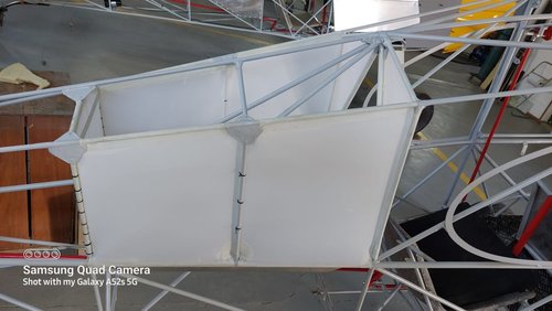

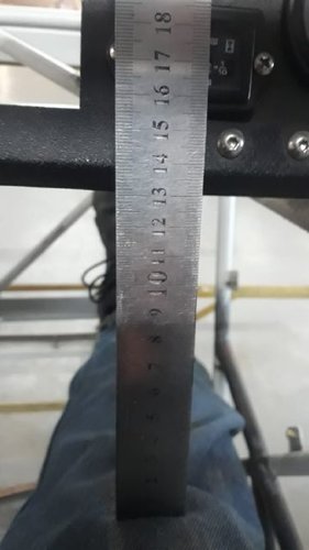

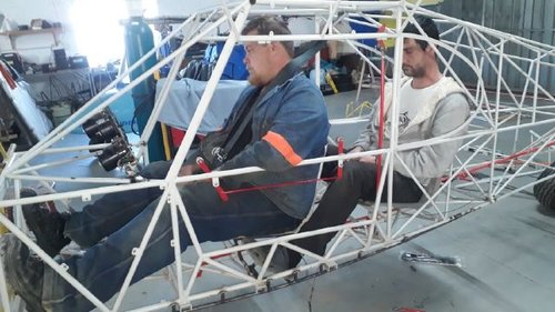

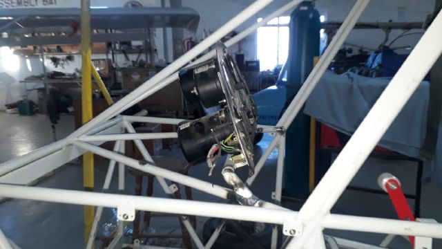

Here are some photos to show what exactly we have been up to with this Renegade frame. Basically it is a couple of ergonomic changes to improve pilot comfort. The two "test dummies" are both over 6 foot tall. Joos, the burly one in the front seat is 6ft 2, and Pierre the more slender one in the rear seat is 6ft 1, and has a size 10 shoe, note the position of his feet.
1) The instrument panel has been moved foreward, now tall pilots have more "knee room".
2) The position of the rear occupant`s rudder pedals have been moved away from next to the legs of the front occupant.
3) Toe brakes will be used for both front and rear .
4) The door frame has been made bigger to the front to facilitate those pilots with less "bendy" joints.
5) The front seat frame also got a bit of an adjustment, notice the good headroom for those "grain fed South Africans"

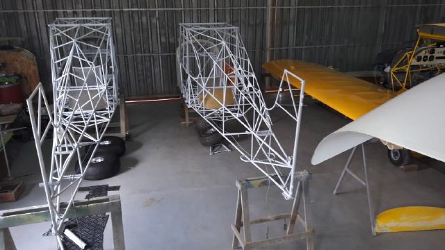

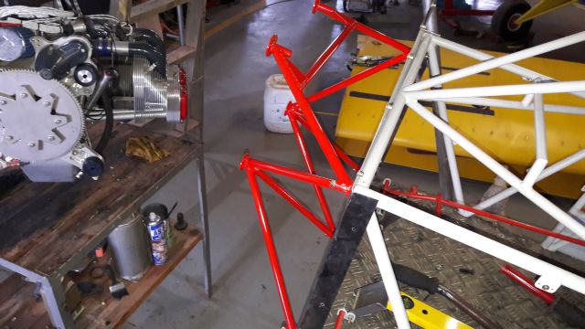

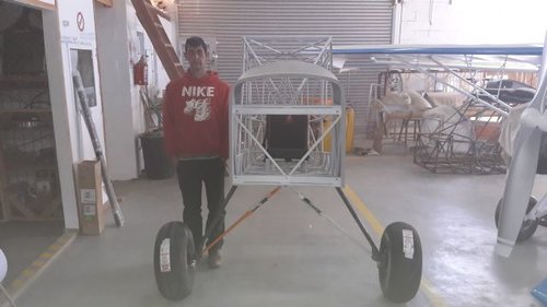

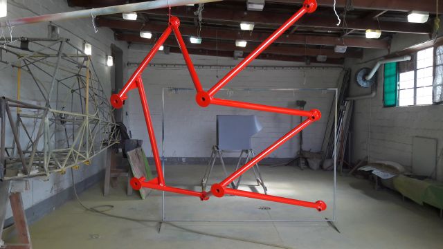

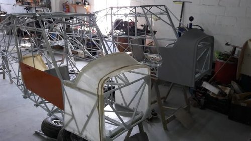

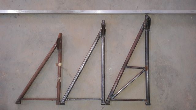

The Cubby Maverick frame is done welded, we finished painting the frame today. Next week we will start the Renegade and Maverick builds alongside each other, and take "time lapse" photos as we progress.
Jean.

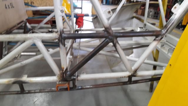

- Posts: 1262

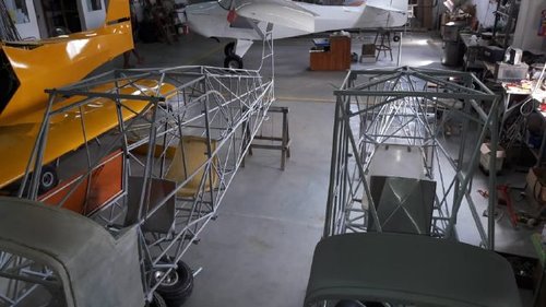

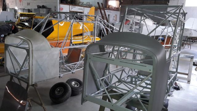

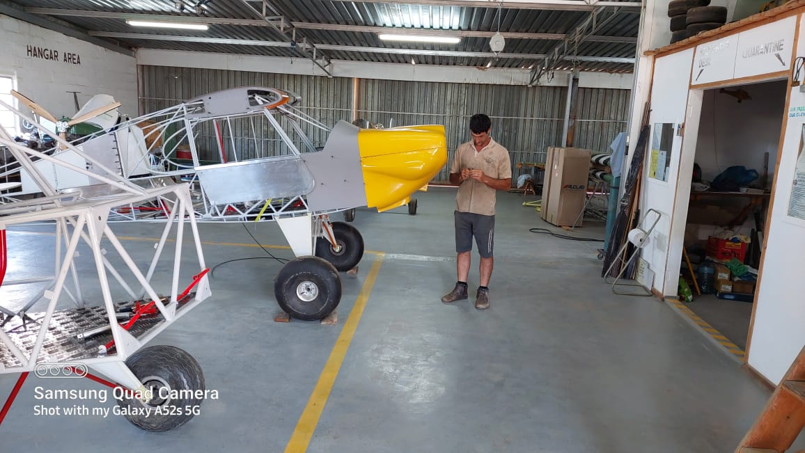

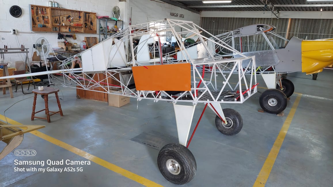

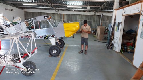

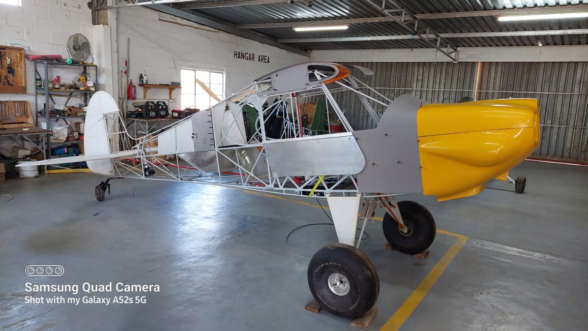

As promised a few photos of the progress on the Cubby Renegade.
Jean.
Jean.
Looking good
