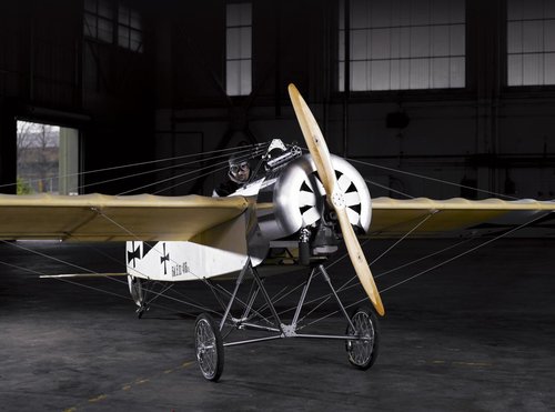

History of the Fokker E-III ‘Eindecker’
A bit of history on the original Fokker E-III ‘Eindecker’ and what made it unique and stand out.
The Fokker E-III was considered the 1st True Fighter Airplane in history, because it was the first airplane to properly integrate a weapon, a machine gun into the airplane. It was fitted with a synchronization gear, enabling the pilot to fire a machine gun through the arc of the propeller without striking the blades.
The Eindecker machine gun gave the German Air Service air superiority from July 1915 until early 1916. This period, during which Allied aviators regarded their poorly armed aircraft as "Fokker Fodder", became known as the "Fokker Scourge" (https://en.wikipedia.org/wiki/Fokker_Scourge).
The Allied aviators had better performing airplanes, but the accuracy of the straight on machine gun of the Eindecker meant the Germans could simply point their airplanes head-on and shoot.
The nickname Eindecker means ‘single wing’ monoplane and it used wing warping for control instead of ailerons similar to the original Wright Brother control method. The wing typical of the aera is an undercambared wing. In comparison the modern day replica I am going to build has Ailerons and a trusty Clark Y wing profile.
