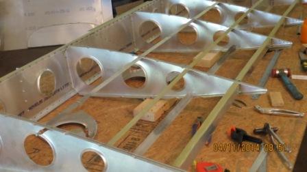

83C Left wing anti oil canning channels fitted.jpg (31.94 KiB) Viewed 20504 times
83B Left wing rear channels fitted.jpg (31.25 KiB) Viewed 20504 times
83A Left wing raer ribs fitted.jpg (29.99 KiB) Viewed 20504 times

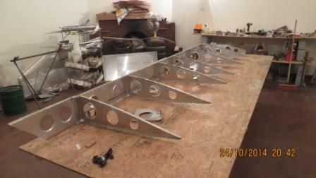

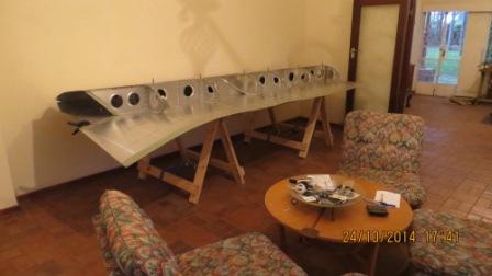

83 Left wing Spar.jpg (28.08 KiB) Viewed 20504 times

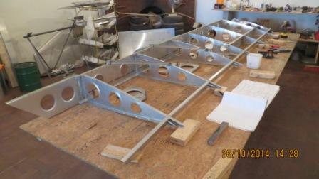

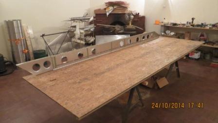

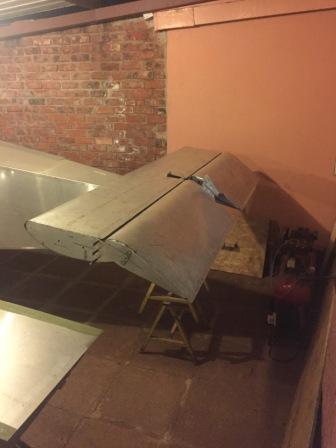

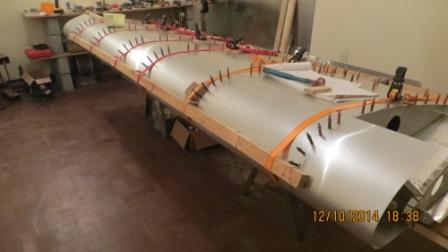

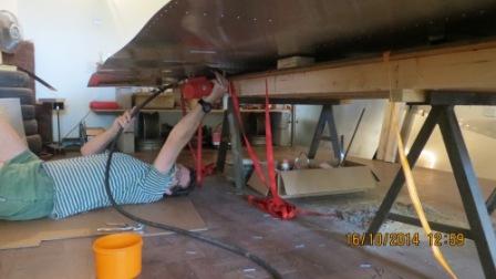

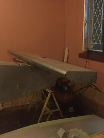

Here with an update on the build. Right wing is as far as I can go as I still have to make up the fuel tanks. Plan now is assemble the left wing upto fuel tank instalation stage,have both wings inspected and signed off for closing up.In the mean time here as some photos of progress. Building the 2nd wing is so much easier than the first wing. Actually had a good laugh at how I struggled to build the first wing as compared to how easy the 2nd wing is coming together at this stage.

I had to laugh when i saw the second last Photo. They (whoever they are) say that only mechanics and prostetutes lie on their backs and work. vhpy vhpy

:lol: Ranger I think I need to respond pronto here before our members go off topic seeing me enjoying WORKING (**) lying on my back :lol: :lol:
For the record you are 100% correct, I am a motor mech by trade, not as glamours as the other trade you mentioned.

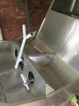

A big hello to the guys following my build and pushing me to update my build blog and apologes for not keeping the posts current.So here a quite a few pics of the build.
I have been a little slow as I am doing my PPL at Executive Air based at Charles Prince, Zimbabwe for those who dont know where CP is located, at the same time. This morning at Exec flight school was a big morning for me as I went solo this morning.
Right back to the important topic, the build.

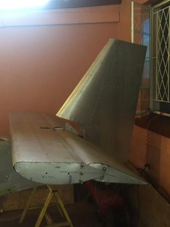

93B Rear Emapenage.jpg (22.24 KiB) Viewed 19636 times
93A Rear empenage.jpg (24.62 KiB) Viewed 19636 times
93 Rear empenage.jpg (20.55 KiB) Viewed 19636 times

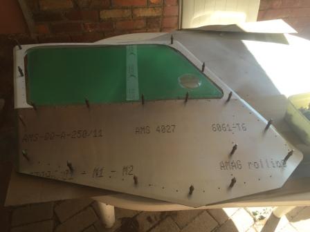

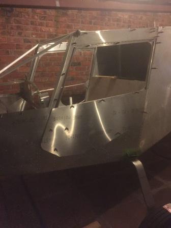

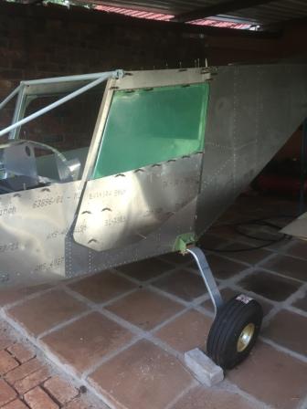

92C Cabin door complete outside.jpg (22.28 KiB) Viewed 19636 times
92B Cabin door complete inside.jpg (24.49 KiB) Viewed 19636 times
92A Cabin doors.jpg (27.01 KiB) Viewed 19636 times
92 Cabin doors.jpg (23.11 KiB) Viewed 19636 times

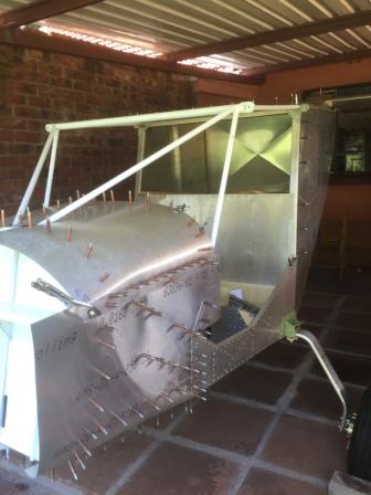

91 Forward top skin fitted.jpg (30.93 KiB) Viewed 19636 times

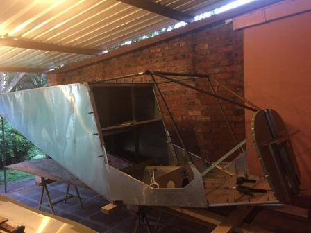

84 Joining Forward and Rear fuselage.jpg (30.18 KiB) Viewed 19636 times

Thanks Goose, its starting to look like a plane now thank goodness after all this time making parts and assembling. Next is to weld the 4 fuel tanks fit them into the wings and cloase up the wings.

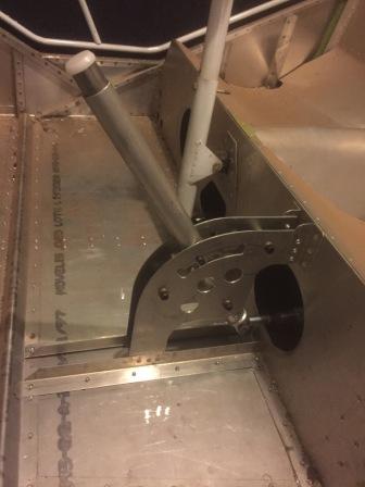

95C Upgraded flap control.jpg (26.34 KiB) Viewed 19352 times
95B Upgraded flap control.jpg (18.44 KiB) Viewed 19352 times

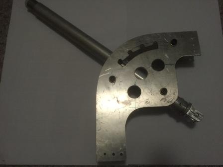

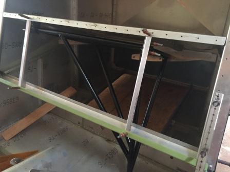

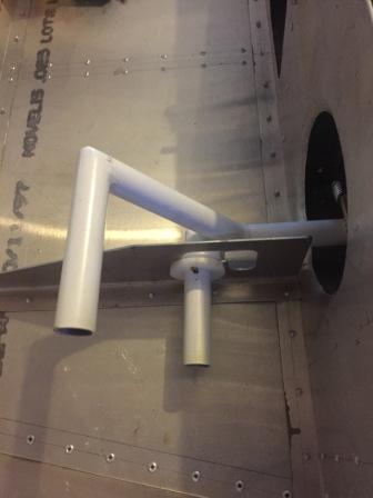

Work has started again on the build now that I have a little bit more time to spend on building.Just completed the upgrade 4 position flap control.Took a bit extra time to make as no drawings available so worked from a photograph of this upgrade.

Hi MRP
Good to see you are still building. The end is getting closer (^^)
Did they change the flap degrees with the new plate
Groete
Goose
Z-MRP
Going for flight test
Posts: 190
Joined: Fri Jul 25, 2008 11:35 am
Re: CH 701
Postby Z-MRP » Fri Oct 14, 2016 2:40 pm
Hi Goose, following the Zenith video of this upgrade the total flaps is still 15deg but now have the option of 5 and 10 deg.
With the original flap control it was 0 or 15 deg only.
I know the savanah goes into higher flap deg numbers but I have stuck to info that was given in the video promotion of this mod.
To buy the mod is expensive $355.00
Having plenty materials left over this mod cost me not more than $20 and a few hours sceeming how to make it.
