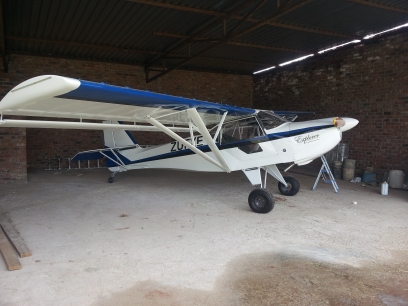

Niek Behr built this Explorer in his garage. We are doing the final commission for him. BMW GS 1200 engine, IVO CS prop.

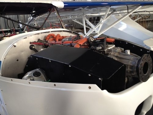

What gearbox did he fit to the BMW

The Gearbox is fro Take Off in Germany. Custom made for the BM motors.

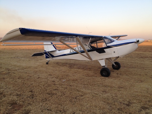

All is done. Did some high power runs this afternoon. Getting 6900 at WOT. I will set the pitch a bit coarser. 6500 will probably be Ok for the first flight.
Now for the final paper push.

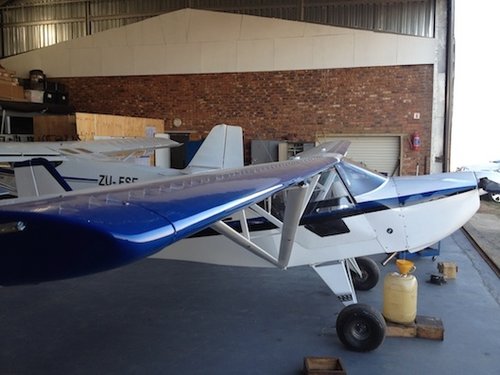

Some more

I know a while back there was experimentation with the bmw 1200 motor. I heard there were problems with uneven cooling. Have these been sorted out? They are lovely motors on the bikes! Would be great to have an alternative to ratex for microlights

Mooi Niek sal wil hoor hoe dit gaan daardie engines is sweet as jy aandag gee aan die baffles en die olie verkoeler loophulle nie warm nie. Laat weet as die pampiere daar is. My nuwe projekkie is amper klaar.
