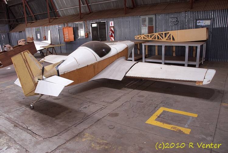

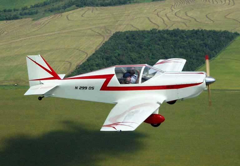

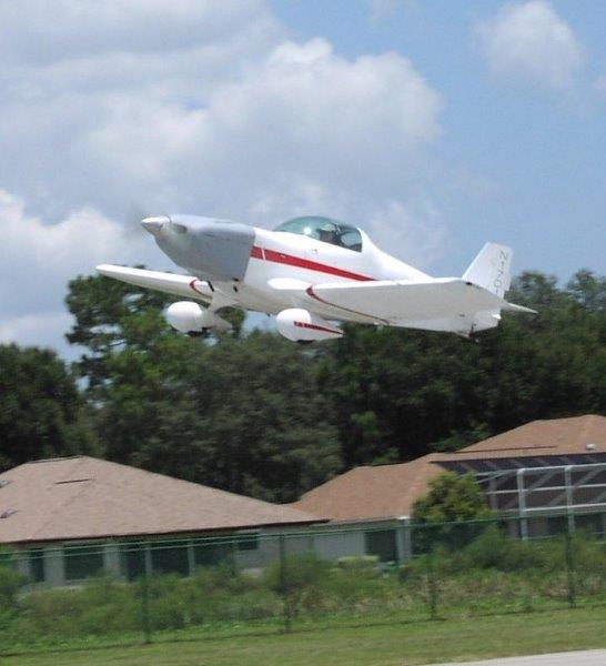

A few more flying KR photos....

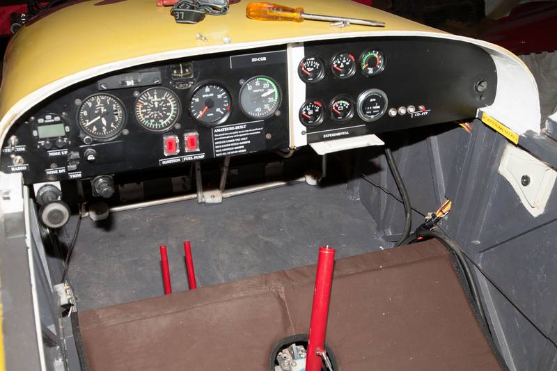

Here are the instrument panels of VYZ and CGR, I prefer "steam gauges" for the primary instruments, after 30+ years in IT I do NOT trust electronics
ZS-VYZ
ZU-CGR
Since these photos were taken I have made a few small changes including a new radio and transponder in VYZ

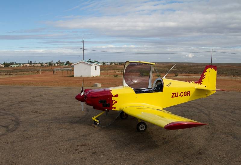

Leaving Saldanha and flying along the west coast in ZU-CGR
Parked at Vredendal
These planes have the speed and range that allows you to really explore the country!

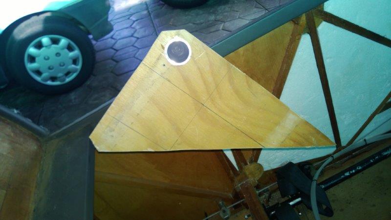

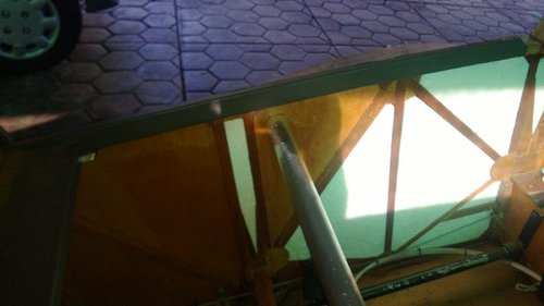

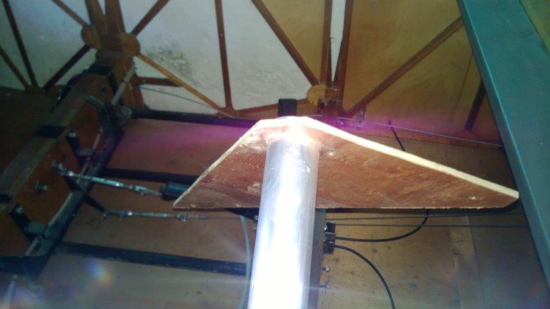

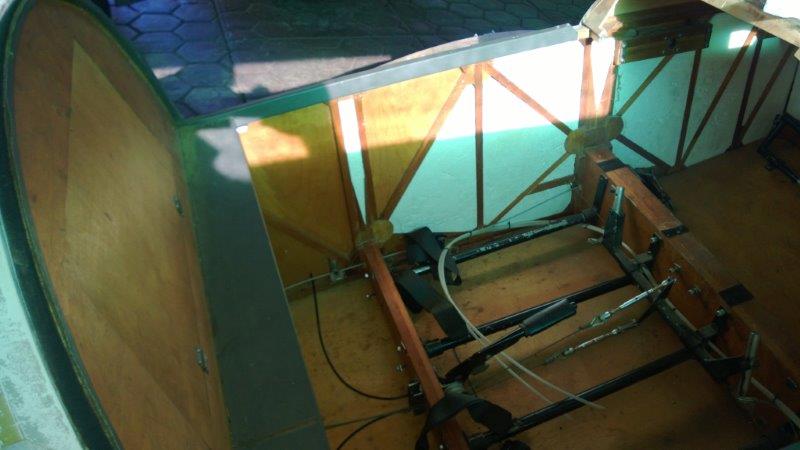

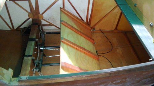

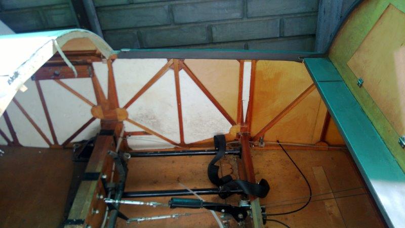

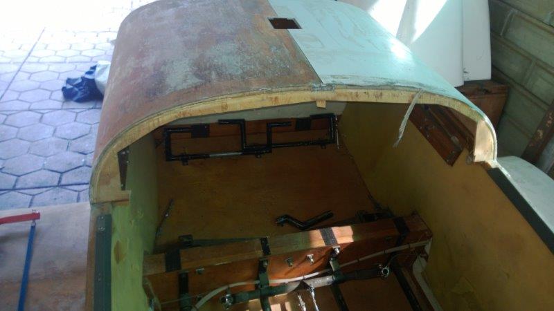

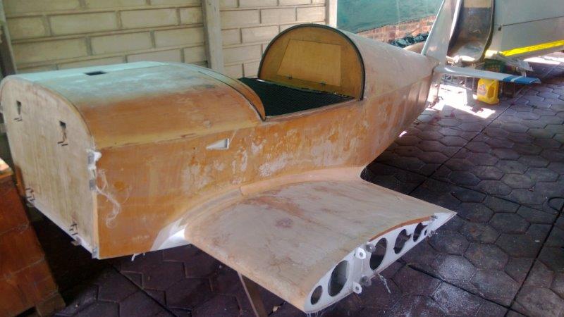

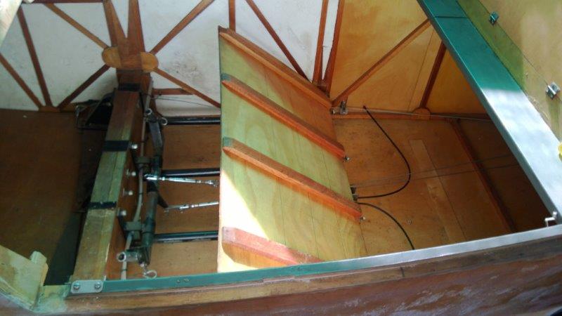

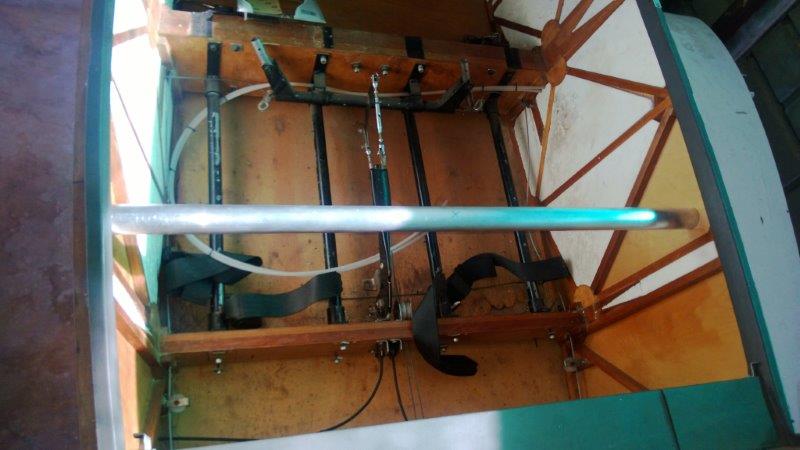

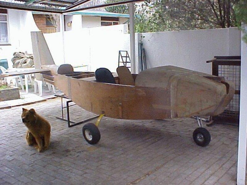

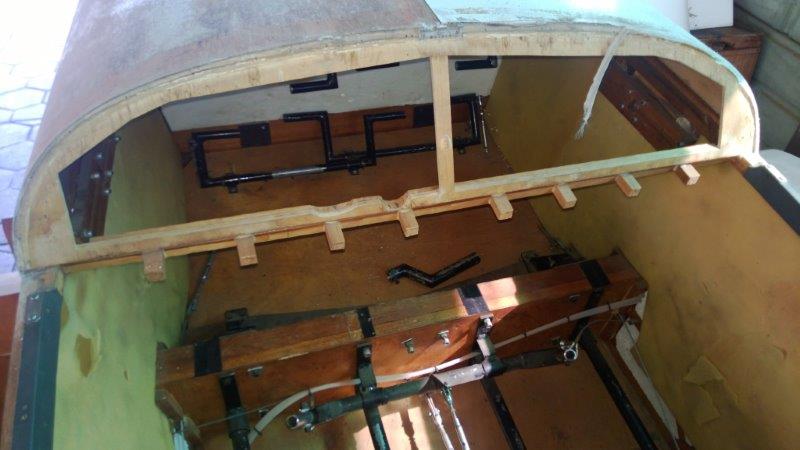

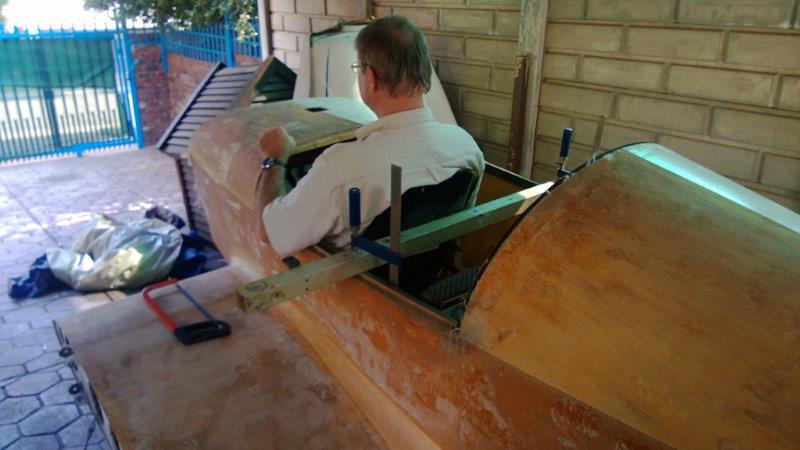

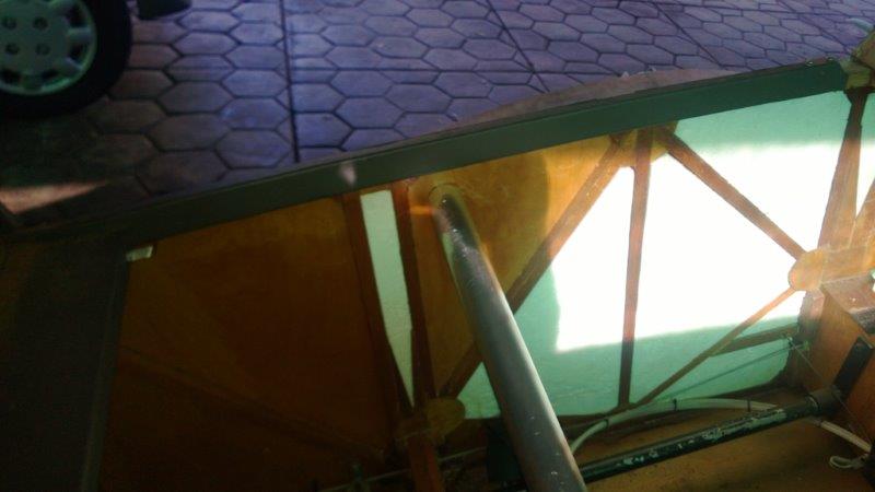

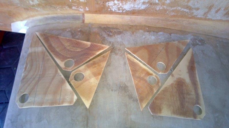

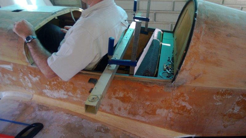

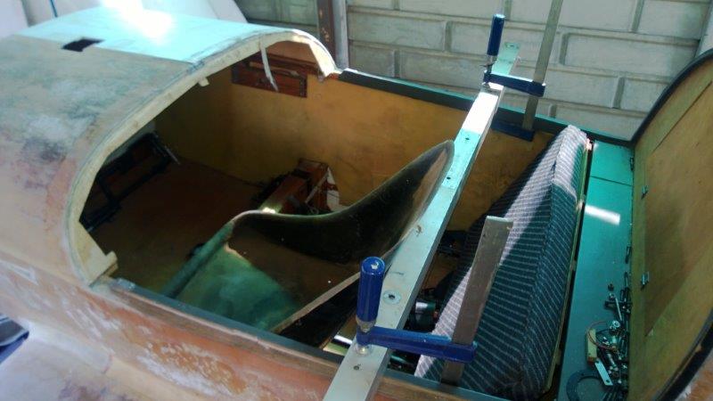

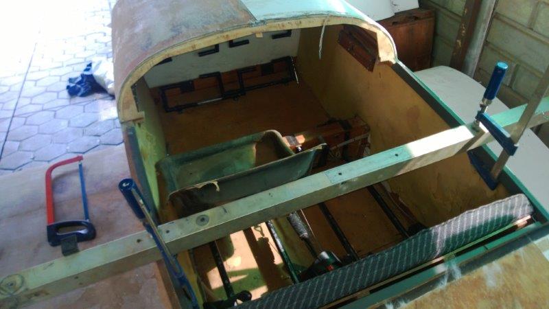

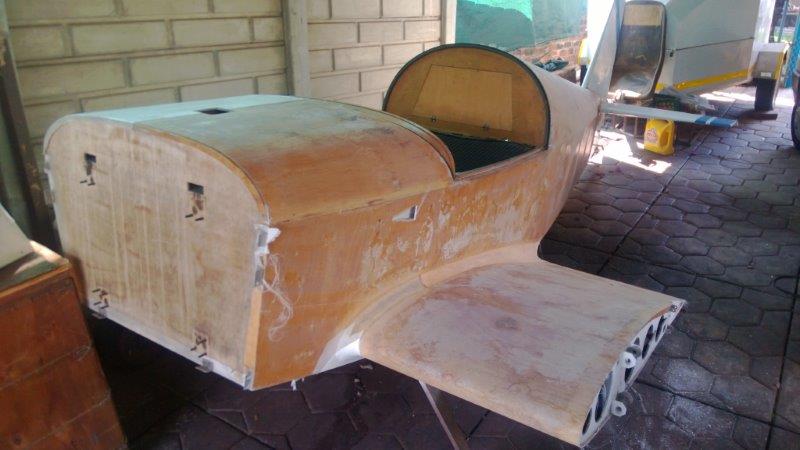

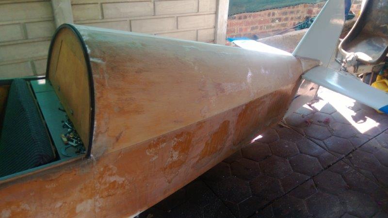

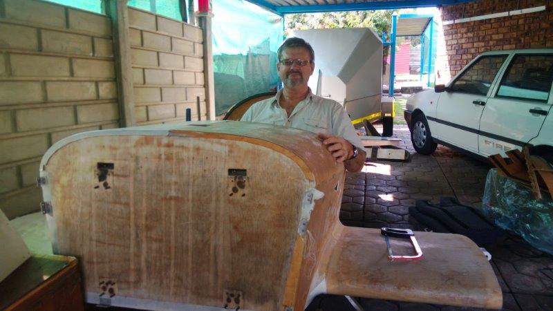

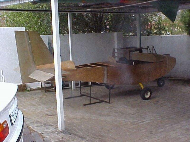

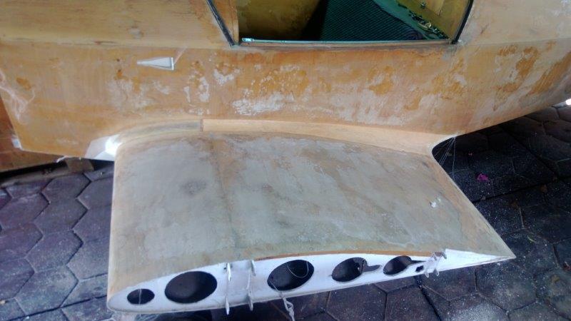

Surprise!

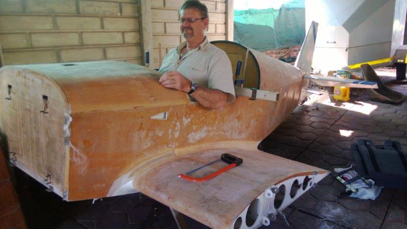

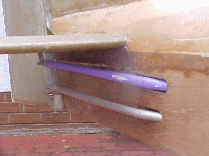

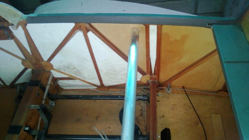

The complete aircraft is built out of wood, masterbuilder style. Even the wings are covered with wood ala Pulsar! All wood was covered with cegonite like a radio controlled aircraft which is off course no good for modifications. So all of this this will have to go. Doubt if I'll cover her with fibreglass as it will only add weight. Maybe I'll reconsider for the wings...
Dash will have to go to make space for new seating arrangement. Notice how far forward the occupants position is moved. Very, very, very good for the cg! The cg of someone sitting in an aircraft is normally their navel. So in this case the weight of both the pilot and passenger will be just about at the back of the main spar. This is right in the centre of the allowable cg range. One cannot place the human bodies at a better position. The rest of the aircraft/engine will balance each other out perfectly. In any case, this is as far as my 6 foot long body can move forward whilst still having proper rudder control. I can off course modify the bottom of the firewall ala Jabiru and move the rudder pedals forward - still thinking about this.

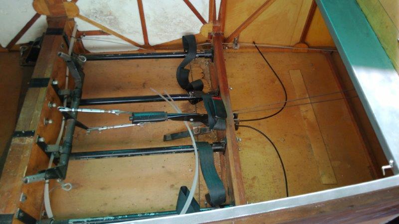

The landing gear and mount is very, very strong and the attachment the best and strongest I've ever seen. Will post some pics later. However, it's heavy and will need to go. So she WILL be changed into a nose dragger which is very good indeed. I am thinking of mounting the main wheels spring arm to the forward wing attach fitting. That way I do not need to cut away too much of the existing emphenage.
See my arm position outside the fuselage? New canopy will allow for this, giving much, much more space inside! I'll cut away most of the forward turtle deck, making it even roomier. My left arm will rest on the window sill with the T throttle just ahead of my hand. The passengers right arm will rest in the same position outside of the current fuselage. The front of the canopy will be ala Swearinghan SX300 style and will look super modern. The rear of the canopy will be ala BX Cherry, blending from above into the current rear turtle deck. It will all look modern and pleasing when done as I hate ugly!
All in all I'm elated with my project and my idea. She's going to be everything I've promised.
Cheers all,
Henni
Cheers all,
Henni

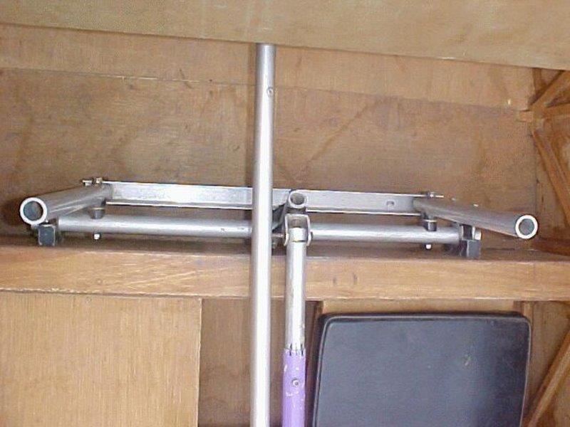

Hi again,

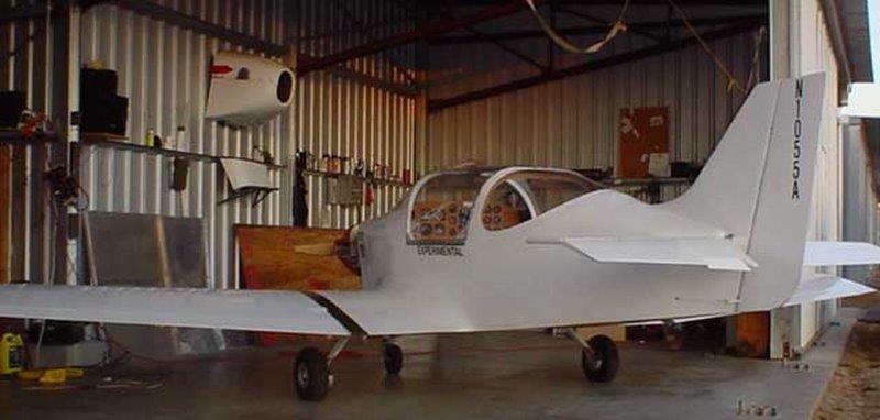

My canopy will be a combination of all of these. The landing gear will be almost exactly like I did it before on this project, only I'll mount the main gear leaf springs to the rear of the main spar wing attach fittings. Steerable nosewheel will be the same as this. All controls will also be the same as these, only I'll have one centre stick only so as not to interfere with the forward fuel tank position. If needs be, I'll divide this tank into a left and right halve with the controls running through the middle.
Fuel tanks will most probably go right behind the main spar under the seats and right in front of the main spar under the legs without the need to open the wings again. That way I'll keep the cg in place under all conditions.
The fuel tanks are easy to make. First you shape it roughly using polystyrene. Next you cover it with PVA paint or so, and then cover it with fibreglass. When done, you put petrol in it which dissolves the foam completely leaving you with a fuel tank shaped to your choice!

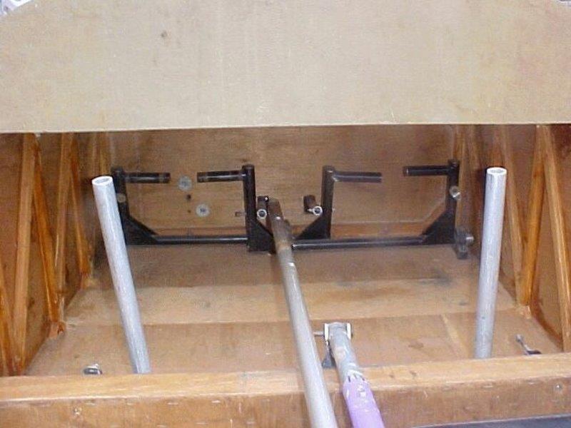

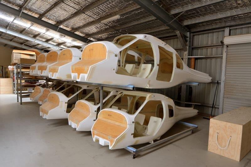

Note how Jabiru moves the rudder pedals forward. I only need to bulge the firewall ply around the rudder section like this - no need to rebuild the whole of the firewall. Will post pics when done to show what I mean. Main engine mounts will still attach to the original firewall bulkheads.
So, she'll most probably weigh less than 500lbs, with the VG's stall under 40mph, cruise around 120 - 130mph two up at 18l/hour, be rather roomy inside (by KR2 standards that is), look not to shabby and she'll really be able to go places! I can't wish for more without having to be wealthy first...
Keep well all,
Henni

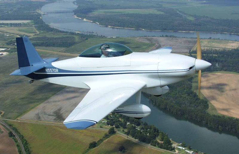

Found something interesting for those seriously interested in aerodynamics:
Airworthiness analysis of a modified KR2 experimental aircraft
The KR2 in formulas and numbers
Here are more interesting reads:
2010 KR2 Mishap
and another one:
The KR2 was designed by an Electronics Engineer.
Here are some really heavy KR2s:
"The empty weight of Bob's airplane was more than 790 pounds". Keep in mind that the designed empty weight was a mere 450 pounds!
Mark Langfords
• Empty weight: 760 pounds - 450 pounds called for in the plans
• Gross weight: 1200 pounds - as opposed to the 900 pounds in the plans
• Fuel capacity: 16 gallons
• Top speed: 191 mph TAS (true airspeed) with 3100cc Corvair engine and Sensenich 54x54 prop (turning almost 4000 rpm), 184 mph TAS with Sensenich 54x58 (but turning only 3400 rpm, and burning less fuel).
• Fuel consumption: I get 42 mpg while flying at 160 mph TAS at 10,000' running "lean of peak", which is how I always fly at altitude.
• Stall speed: 57 mph with split flaps deployed, 62 mph "clean" - 45 mph in the plans
• Glide ratio: 11.8:1 engine at idle or engine stopped (almost the same number)at about 80 mph, averaged from 10,000' to 2,000'.
• Propeller: currently a wooden Sensenich 54 x 58. I've tested at least 10 different props, and this one gives me the best speed and economy with a reasonably low engine speed.
So, this is really one versaltile aerie with extremes to all sides currently flying and flying well. Mark has close to 1200 hours on his heavy KR2 which says a lot for the design!
Keep well all,
Henni

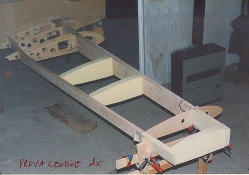

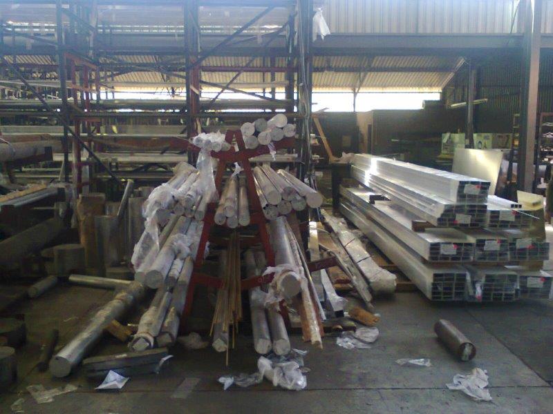

Hi all,

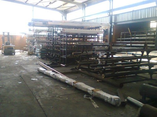

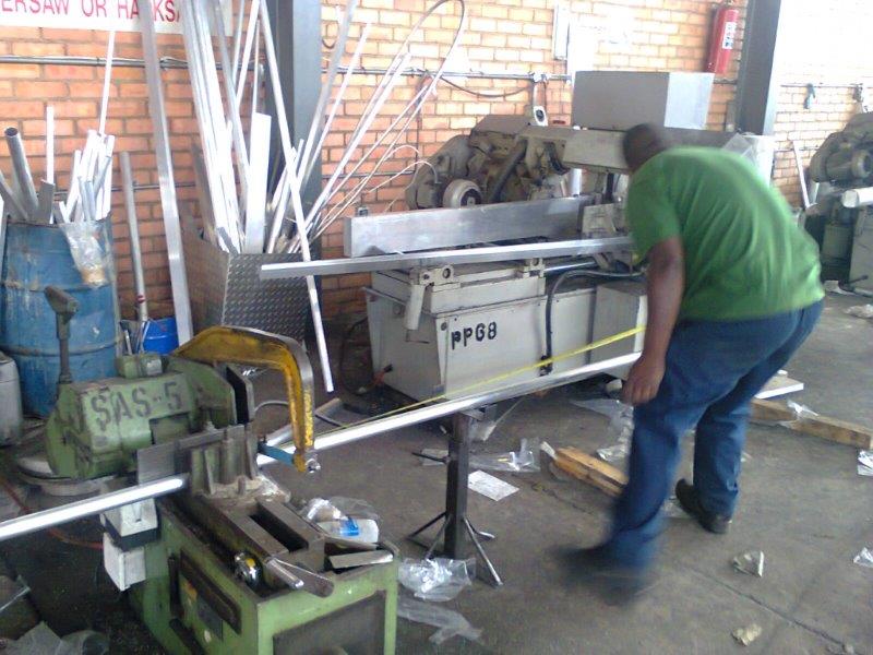

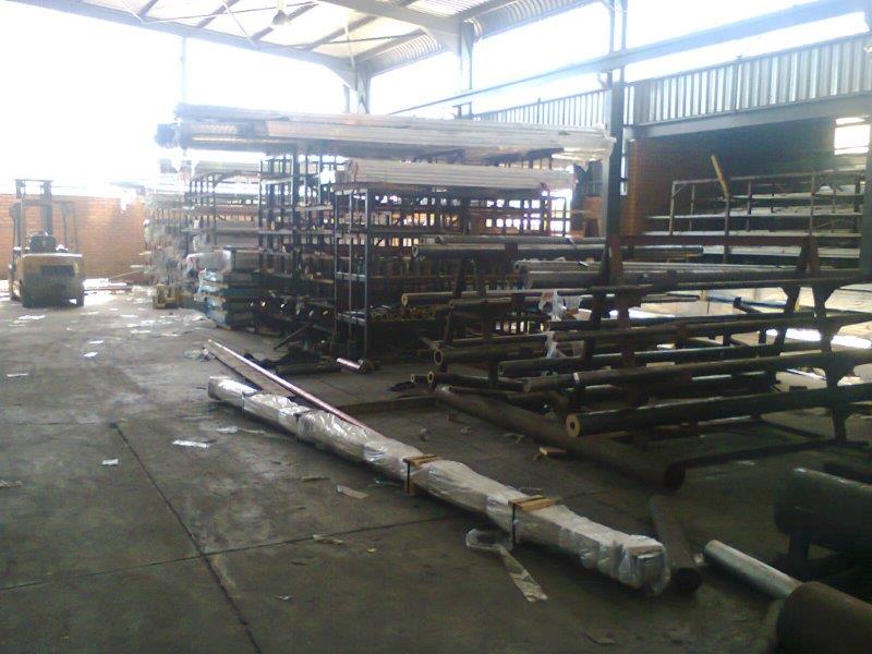

Purchased some more aluminium and also some much required tools. I also fabricated some more parts. Will take pics on Monday & post some over here. I've decided to first finish the engine mount before I continue on the fuselage mods. I can now at least focus on making the engine fit inverted inside the stock standard KR2 cowling. No need to hang it all the way out there in the front any longer. I think my engine should be hanging by mid this coming week. Then I can start mounting the radiators & plumbing. Looking forward to it.
Also, received my engine vibration rubbers from Boet, so I now have everything required to mount my engine. I also have enough aluminium to mount my new fibreglass seats in their new position. By the end of this coming week, if all goes well, I should be able to show some good progress.
This is where I purchase all my aluminium from - virtually just around the corner from where I work! What a blessing indeed...
And last but not least: My project is now also listed over at the KRNet.
Keep well all,
Henni

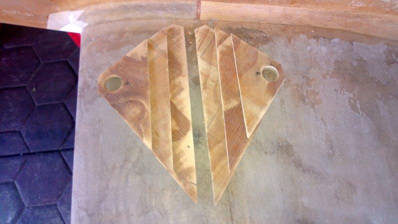

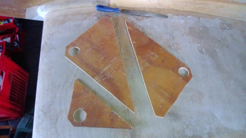

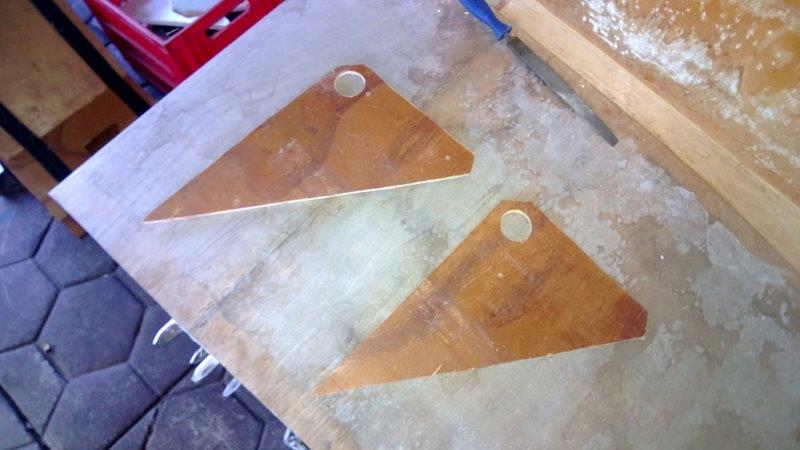

So, today I started with the new seating position. The caption below each photo says it all. Tomorrow I'll continue with the other aux. tube supports and glue all of them in place with tube inserted. I plan to have three pieces of laminated ply at each side to hold the tube in place. I had to use three thinner pieces as they need to bend to the shape of the outside (skin) ply when I glue them in place, one at a time.That way it will be strong enough to support the seats to the rear and also the shoulder harness to the front. I think this was a good idea. Light and strong and no other brackets have to be made and no holes need to be drilled through critical support structures.
The seats will hinge forward from the main spar and will rest against the new tube at the back and via supports I still need to make on the bottom tubes below the spars. I need to be able to hinge the seats forward as one of the fuel tanks will fit nice and snugly below the seats, resting also on the bottom tubes. The lap seatbelts are already attached to those tubes. The shoulder harness will be attached to the thick walled aircraft grade tube behind the seats, the one I'm busy installing.
I really have nothing but praise for the previous builder. Everything is well thought out and built to a very high standard. Such a shame that he could not live long enough to see his dream all the way through. I think about him often & I feel so sorry for him...
I desperately need a sanding block. So will make one first thing in the morning.
Keep well all,
Henni

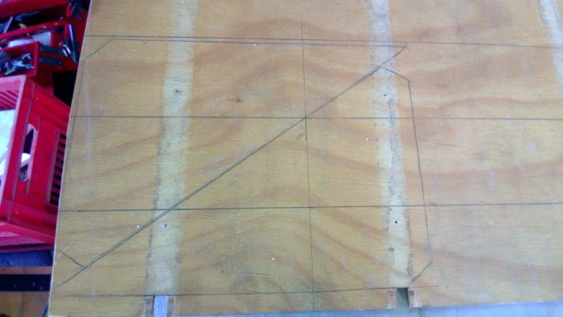

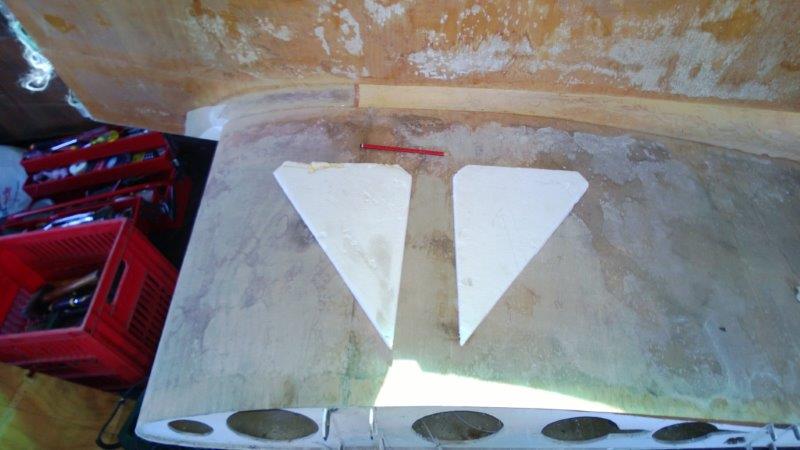

Hi everyone,
Ha! My wing has now become my favourite place for placing everything I intend to photo capture.
This is where I now stand after another day's work. Progress is rather slow as I'm not working from plans, but applying ideas as I go along. See the caption below each photo for description. I did not have to make a sanding block after all. I purchased a ready made one instead. Also found the glue of my choice, so now I feel much better. For serious bonding, I'll purchase the stuff that Piet Propeller uses direct from him, but no need for that as yet...
Tomorrow I'll glue the back seat support tube in place. All parts have now been fabricated. I just need to sand the fuselage inner skins & stringers before I start for proper glue contact.
When I cut the tube to fit, I realized anew just how much the KR2 fuselage widens to the front, where it is not required. Our new shoulder position will now at least coincide with the widest fuselage position. This along with the extra elbow room I'm going to create, will make a HUGE difference to a stock standard stretched KR2 interior. I am well pleased with my ideas and slowly everything is coming together exactly as foreseen.
You can clearly see just how far forward the occupants were moved. Remember that the top seat back position was far behind the rear wing spar. Now it is at least completely to the front of the rear spar. I can still control the rudder pedals with ease with my 6ft body, but there is a good chance that I'll bulge the firewall in the rudder pedal area and move the pedals forward, just because it CAN be done!
I am also now even more convinced that she will turn out to be everything that I wanted and a proper, fully able full two place aerie. Not sure if I can call it a KR2 anymore. However, I'm rather convinced that in future many other builders will follow in my footsteps as the results will just be amazing considering that it started off as a standard KR2. I'm also convinced that when she flies that we'll see more two stroke powered KR2s all over the word as this design was meant to be light right from the onset.
Heck, I might even be a trail blazer for this new concept... To design something like this and build it from scratch can be done with ease, but to radically change something that has already been build without tampering with the load bearing components requires just a little more head scratching.
Keep well all,
Henni
