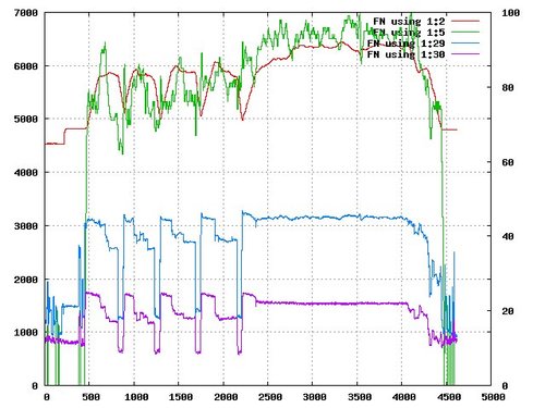

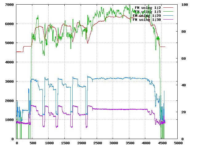

There was some really good weather on Sunday afternoon, so I managed to get a good set of climb and dive tests in:
The good news is that the numbers were pretty good this time. Speeds stable within +/- 1kt for over 1 minute each time. Gave me some good numbers to work with. The bad news is that the resulting plots do not 'peak'. I started the low end of the tests at 55kts for a dive and 60kts for the climb (Vref is 57kts). So, best climb, and best glide speeds will be somewhere below Vref - but seeing as I will not climb/dive in those ranges, I will not even bother testing at those speeds.
Had a nasty scare doing the tests though. Was doing them in the circuit to have a 'safe' place to do them, as I would have to focus on the instruments a lot. Only to have a Pipestrel fly over about 300' above me - he flew straight through the circuit (below circuit altitude) without a single radio call. But I suppose I was primarily at fault here, as I was not maintaining a good lookout...
Best climb at 60kts (with the nose seemingly pointed straight at the sky) was 440fpm with nearly full tanks. Loading pax is still going to be marginal.
The long flat bit towards the end was a scenic cruise at 22" MAP (75% cruise) out to Bronkhorstspruit, and further East. Trues out at 89KTAS burning around 16l/h.
