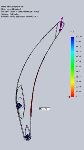

What I did spend a lot of time on recently is doing analysis of the pylon. The original design of the pylon required a lot of strengthening plates if I wanted to make it strong enough. I have therefore sit down and basically started from scratch with the pylon.
The old design made use of square tubing, the new design is constructed from 2mm plate and flat bar. The results of the numerical analysis is shown below.
Above is shown the factor of safety of the pylon with a 4g load. The minimum factor of safety is about 4.7 in this model which is well within the limit of 1.5 required.

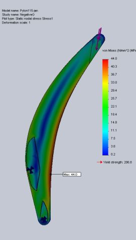

This is basic the same analysis but just a bit more colorful picture. It shows the Von Mises stresses in the pylon with red being the highest stress. It shows that the highest stress is about 44MPa (Stainless steel yield strength is about 205 MPa)

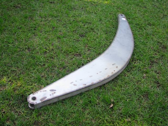

The pylon is now close to finished. The side plates were lasercut from 2mm stainless steel. The front and back is made from 50mmx5mm flat bar. I tried to bend the front and back myself but at the end I took it to a shop with a large roll bender. Stainless is a bit difficult to bend because it tends to spring back.
I helped Gerrie to tack it together and then he welded it. He had to do it bit by bit, about 70mm at a time, over cross to make sure that it does not wrap.
The middle mounting hole is still missing. This I will only drill once the frame is welded to ensure that it fits.
The pylon is quite heavy, about 16kg. To put this into perspective, compare it to the frame which is about 17-18 kg. I am still within my weight budget of about 210-220kg for the trike. That will leave a useful load of about 230kg for the PIC, PAX and fuel.

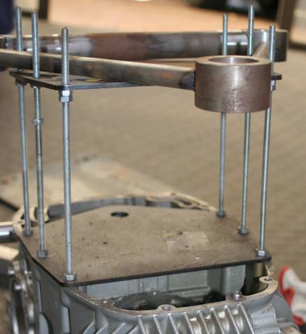

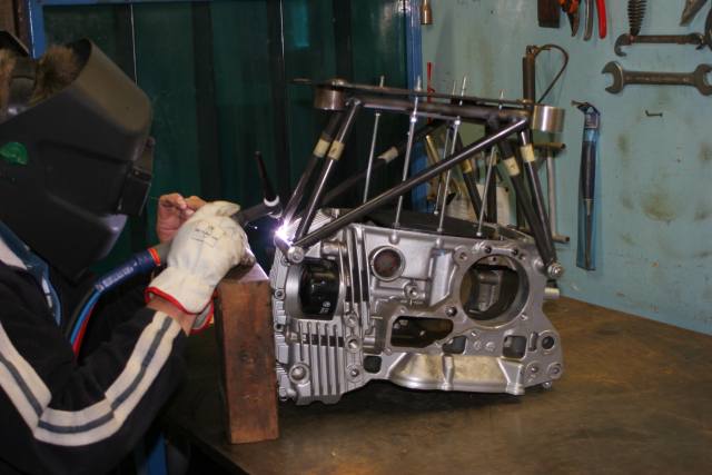

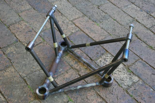

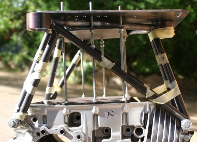

Worked on the engine mount based on the one used by OupaG. I needed a jig for the engine mount but unfortunately OupaG 'lost' his original jig during the last reorginazation of his workshop. I therefore used an old engine block and some plates that Oupa had laser cut to make a jig.
Frame triangle aligned
Most tubes cut en fitted.

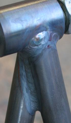

Welding the engine mount
This is what a weld should look like
The result
The engine mount is made from Cromolly (4130). Does anybody know if I need to heat treat it and at what temperature? The information on the internet is a bit confusing because some say you must while other say that you do not have to if the wall thickness is < 3mm.

Just back from a trip to Namibia and while I was away the new engine mount materialized. The photo's do not do justice to the beauty of the engineering involved also the full stress analyses I think Ystervark should show us some pictures of the forces in the engine mount. If you compare the welding of this engine mount to say amount of a Cessna 150 you can see that sometimes NTCA can do better. Some of the aircraft that are certified have the paperwork but not always the quality. I'm proud this type of work is coming out of a home workshop with the help of our welder Gerrie.

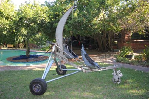

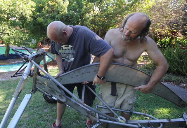

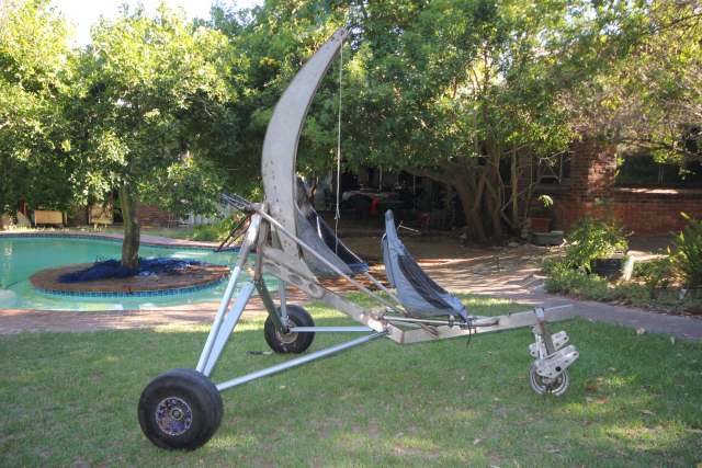

The Ystervark is is making some progress again. I had to make a lot brackets which Jan tacked for me. Last week it went to Gerrie for welding. Over the weekend I started assembling everything. I will have to take it apart again to electropolish the frame and anodize the aluminium.
Fitting the pylon
Looks OK
All together
I borrowed some rims from OupaG (mine is not ready yet) . The front tyre and engine I will fit over the weekend. I will then do a quick weight and balance to determine the position of the final hole in the pylon.
The main outstanding items are the pod and the fuel tank which I will tackle in the next week or 2.

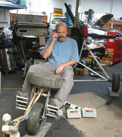

To make sure that the hang point is a the correct position before the final fitting of the pylon all components were fitted and equivalent weights were added for those components not available. The wheels and tires were not the final ones to be fitted since they are not ready. The fitted ones are about 2kg heaver than the final ones should be.
The wing was not fitted since that the CFG on a trike should be such that the back wheels touch before the front wheels while hanging from the wing. The fuel tank, fuel and PAX was also ignored during this test since they are very close to the CFG and should have very little influence on the CFG. This will be confirmed after final assembly.
The hang point was used as datum. A correct CFG should be at least behind the hangpoint. Surprisingly the calculated CFG was in front of the hangpoint! (about 20mm)
This did not correspond to my initial theoretical calculations that indicated that it should be about 40mm behind the hang point. All calculations were check again and an error was found in the spreadsheet where some of the engine weights were added twice. Stupid me.
This was corrected, which moved the hang point about 70mm forward. This corresponded within about 10mm of the measured CFG.
The hang point needs to be moved 70 mm forward. Fortunately the pylon holes must still be drilled and can be moved moved (that is why I have done this now because after this I will need to build a new pylon if I want to move the holes and believe me, I do not want to do that.)
The total weight is, not surprisingly, more than what I anticipated. The current weight is about 170kg but that is without the fuel tank and wing. The fuel tank is about 5 kg and the wing is 50 to 60kg. That gives me between 225 an 230 kg. Add 2 persons of 80kg+90kg gives me 400kg which leaves 50kg for fuel (that is 70liter). It should still be OK because it is unlikely that you will have a passenger with a full load of fuel.
Doing the weight and balance in oupa-G's workshop. You can see the tire in front of me which is the equivalent weight for the pod. There are also some oil containers on the engine for the radiator, air cleaner and fluids still missing.
