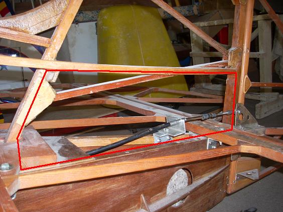

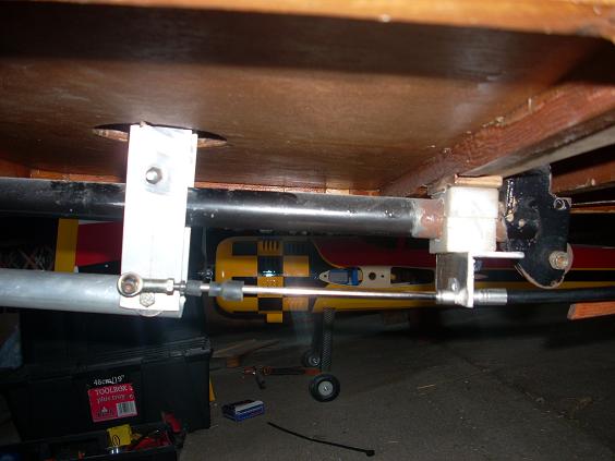

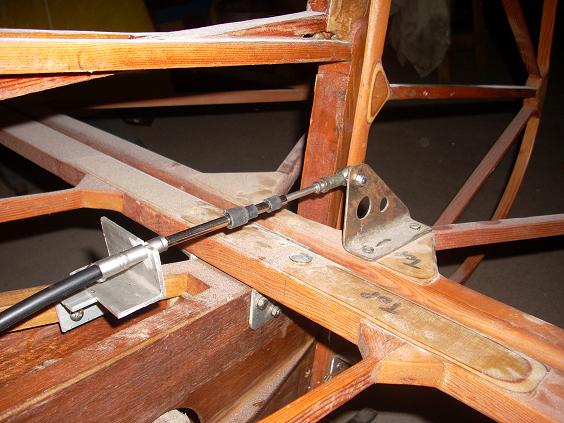

Got the elevator control cables installed and working with temp mountings for now we will redo the mounts after covering.

Hey Trev why after the covering - surely before is better??Go Vert wrote:Got the elevator control cables installed and working with temp mountings for now we will redo the mounts after covering.

Not that i am an expert, but that is my question also. I build aeroplanes for a living and the self imposed rule is : never leave a job for later if you can finish it while busy with it. This has made life mmmmuuuuccchhh easier for me on many occasions. Just my humble opinion, not trying to tell you what to do Trev. I must say you are doing a very nice job, and i admire your dedicationbluesmancoops wrote:Hey Trev why after the covering - surely before is better??Go Vert wrote:Got the elevator control cables installed and working with temp mountings for now we will redo the mounts after covering.

Well guys the reason is that I still need to give the mounting system at this point some serious thought before doing it and this entire area which is marked in red is not covered with ceconite there is a hard mounted panel which covers it so there is no difference once the plane has been covered but everything behind this will be permanently fastened before covering. As you guys say its better to do those challenging areas before covering.
Trev

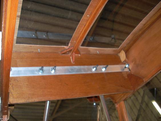

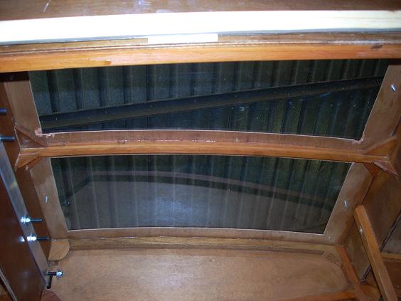

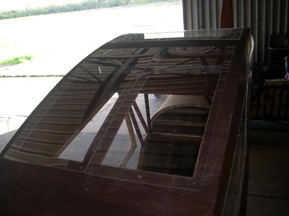

Just installed the top cabin windows, will be pop riveted when the final window fittment is done.

And you should move all those controls that are hanging out the bottom of the fuselage, to the inside of the cabin. Much less drag.
