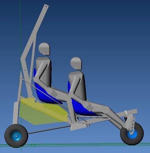

I have just started on scratch building a trike. It will be build based on my own plans but a lot of the ideas will be based on existing designs, especially on Vliegvark's ideas. (No need to reinvent the wheel.)
The main features will be:
1) Use as much commonly available material and components
2) Frame will be stainless steel while most of the suspension and fuel tank will be aluminium
3) Wing will be bought - topless from Yenya
4) Engine a BMW 1200 - I will try to put a belt drive on rather than the gearbox which will be about R25000 cheaper.
5) MAW 450kg
6) -1 to +4g for maneuvers max -2 to +6g
7) > 80 l fuel tank
8 ) adjustable front seat
9) brakes - must still decide
10) trailing link front suspension
11) back suspension traditional trike design with shock absorbsion
12) cruise speed I aim for 105 km/h
If anybody is interested I will make the plans available.
Currently I am more or less finished with the drawings and I have just ordered the first laser cut parts.
Here is a drawing of the frame without the wing and engine.

This looks like another interesting post that I'll have to follow closely. I'd love a set of plans when they are available Ystervark. Strongs with the planning!!!
Re: Scratch build a Trike
Fantastic Project! Looks almost like the DTA! About the brakes, I would go for two disk brakes on the rear with some lekka fat tires!
Will you be welding the frame together and what is the estimated weight going to be?

Well Charl, I sort of assumed that I do not have to mention that it does not have a profile tube in front. Is there ather way to build a trike?
Yes the main concept is based on the DTA Voyageur. The DTA uses a complicated boxed section pylon made from aluminum, rivets, a cables and glue as I understand it. This design is too complicated for my limited design skill. The rectangular tubes are much easier to design and build. We (vliegvark) have build one in the past already and we have tested it by hanging 3 tons from it which is about 6g. I am therefore reasonably confident that it will be strong enough.
The frame will be welded. The weight is always difficult to estimate and I think that you will always underestimate. I aim for less than 200kg. To give a bit of perspective on how much weight you are going to add using stainless steel:the frame will be made from 80x40x1.5 mm rectangular tubing which weigh 3.86kg/m. you need about 4 m for the pylon and frame which gives you about 15kg. You still have to add all the other stainless steel brackets and stuff which might be another 10kg. The total weight of all the stainless steel parts will therefore be about 25kg. The rest will be the same as a normal trike, so the final weigh will depend a lot on what you add anyway.
I am considering disk brakes. Would even like it more if I can buy them off the shelve. Yes I can make them but I have enough other things to make. Any suggestions where I can find small disk brakes that will fit on a 150mm brake disk? Scooters or quad-bikes are probably where I should start looking.
For those who are interested, the design will be available for a case of beers
, but if you need the money for more trike parts, we can negotiate (may be one or 2 conditions attached).

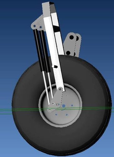

The front fork detail is shown below. It uses a trailing link suspension using normal off the shelve Gabriel gaslifts available at most spares shops. (idea also borrowed from DTA) I have allowed for some alternative as well, you can either use 2 19mm ones with a 200 or 250mm stroke or a single 22mm 209mm. The 19mm ones allow a longer stroke (250mm) because the 22mm is not available in 250mm.
There is no reason why you can not use any other fork. The easiest might be to use a fork, wheel and brake from a old trike.
The 2 drawings show the 19mm x 250mm gaslifts at both extremes. This should give enough travel for the roughest terrain .

Glad some people are interested in building a trike. I think trikes are a bit out of fashion at the moment but if you want to really fly, this is the only way to fly with the wind in your face and you feel the air movement as it plugs on the wing.
By making the plans available I hope to make trike flying just a bit more affordable for those who have the skills and inclination to build their own trike. I will also make a complete bill of material and keep track of cost for those who are interested.
My basic philosophy will be to use material and parts that are easy to find (world wide I hope) while still trying to keep the quality up to or close to aeronautical standards. I will also try to limit the skills and tools needed. A lot of the stuff will be TIG welded which might be a problem for some people but I am sure that you will find a skilled welder close to most major towns. A lot of parts will be laser or waterjet cut which is accurate and affordable.
Stainless steel 304 was chosen because of its oxidation resistance (I live close to the sea) and relative high tensile strength (about double mild steel). Unfortunately it is not so resistant to vibration. I will try and compensate for this by "over designing" it at critical areas where possible and building in some safe guards. An example is the pylon which is one of the critical areas. The pylon section will be welded airtight and fitted with a valve. It can then be pressurized, with nitrogen if you want to, and the pressure can be checked with the preflight. The smallest crack will therefore be detected early and can be fixed. The same can be done with the frame but I do not think it is necessary. The aluminium part will be mainly 60601-T6 which is easy to get and is reasonably resistant to metal fatigue as I understand.
If there is enough interested I will take the different parts of the design and place it on the forum for discussion each week.

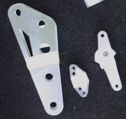

I got my first parts recently
- very exciting for the builder - much like a new tool. Most of the stainless steel is on order as well.
