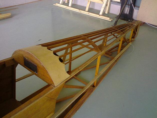

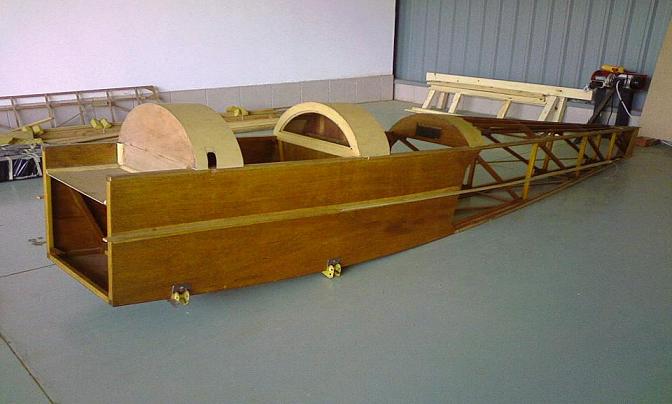

I have recently bought a semi-built Pietenpol Aircamper from Fritz Wolmerans in Kempton Park.
I moved it to my hanger at Kitty Hawk and will continue with the build within the next couple of weeks.
The deal with the wife was that I could get the Pietenpol if she can get the new bathroom she has been "nagging" about for the last couple of years. Well, the batroom is about 80% complete and I have my Pietenpol lying waiting for completion.
Phillip from Bundu Aviation is busy sourcing stub-axles, brakes and wheels for the Piet and I ordered a Chevvy Corvair engine core through him from the USA.
The covering material I will only buy from SA Planes.

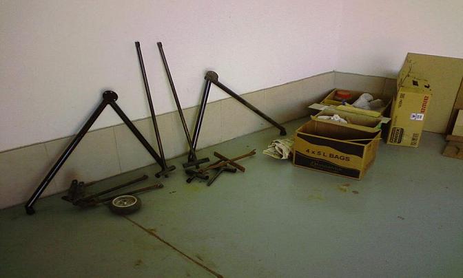

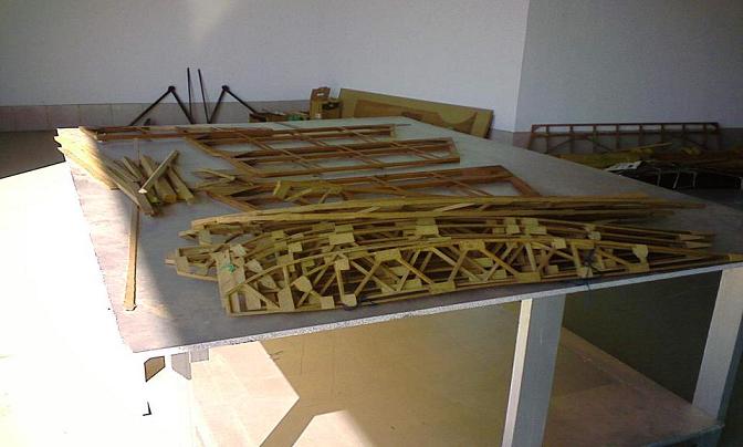

The fuselage is about 60% complete, all of the main wing ribs are complete, the undercarriage is complete except for the bungee cord shocks, the tail surfaces basic structures are complete i.e. elevator with control surfaces and vertical stabilizer with rudder. The control surface hinges are all manufactured, the metal drag- and anti drag cable lugs are present. The main wing spars are ready for installation.
I have since purchased a Piper J3 Cub fuel tank for the Piet, a lot of instruments including an Altimeter, Rev counter, ASI, 2 x VSI's, a slip indicator, a pael mount compass, an Icom radio, two cessna 172 rims and a Cessna 150 prop (which I will try to swop for a wooden prop at some stage).
I also received a heck of a lot of different Spruce profiles, all of the required bolts & nuts with split pin / securing wire holes and slots.
