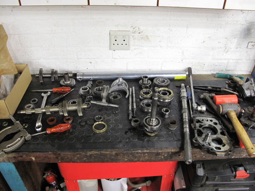

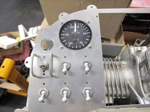

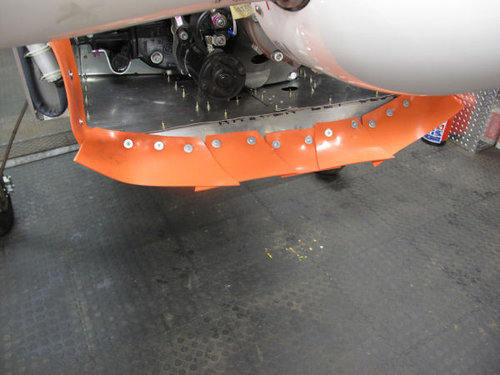

The site is cooking Ystervark is giving very good info on the wires etc. Boet is giving his experience, the electronic media is fantastic , and we can share this knowledge around the world. What an exciting time we live in. On the Bosvark front today I fitted a tapered shim . I had worked out the thickness of the shim and the taper . Then I took a piece of aluminium 1.5mm thick stuck it onto a thick piece of metal and then machined it with my milling machine. Once finished milling I could easily separate it with my pocket knife . The shim was fitted and the wheel alignment worked out .5degree per wheel. Also I received the only analog instrument the ASI. Included is also a slight mod to the baffle it was positioned further down to clear the landing light. Then this month I had my fair share of unplanned maintenance. My Isuzu bakkie at 250000k's broke a bearing in the gearbox. Luckily I got all the parts and this weekend the puzzle will be packed. It interferes with the Bosvark. The long weekend is very welcome . Enclosed some pics.

Those are nice switches OG. Where did you find them please?

They are switches as well as circuit breakers it simplifies installation and wiring. From an operational point of view if a circuit trips you see it on the switch. You can only get 5 amps and 7.5 amps that is all that Republic Air Parts in Pta have in stock. The 2.25" Airspeed indicater is an UME instrument and is the backup of the Voyager also from RAP If you talk to Aubrey or Wimpie they are very helpful. I'm at the moment in bed with flue and hope to shake it of must have gotten it from Boet over the telephone when I was last talking to him. With everything I want to do this coming weekend the flue is not allowed to interfere with Hobbies. So no photies tonight .

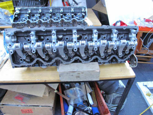

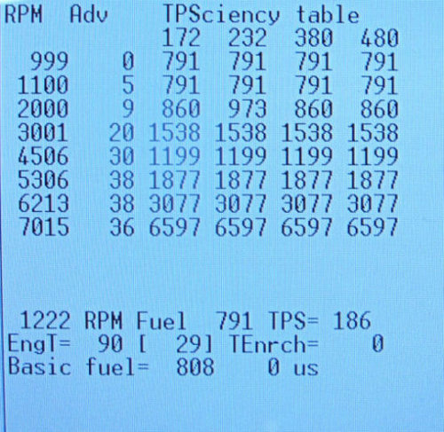

My flue disappeared and my weekend was very productive. Installed my new X-ray machine , rebuilt the new cyl head for the cruiser and received back the turbo and injectors, and did some serious fine tuning of the Eboxi. I enclose a picture of the cyl head with all the roller cam-followers. Lycoming is making such a fuss about this and in the automotive industry it is old head it is also not racing technology but just good modern engineering. Also just a glimpse from one of the tuning pages . The fine tuning helps when Ystervark is there I call the shots if we are rich or lean and he hits the key-board. The engine is really smooth now and she idles with the prop standing tjoep-stil. Again just some foties

Oupa`s flue could not keep up with him as he is too busy for it to be able too keep up, so it flew away. Jyst spoke to him, and he is just as sprightly as ever. Me still blowing and hoping. Sadly, Oupa`s friend and helper, "Skroef" passed on on friday. He would still have painted the stripes on Oupa`s cowling. now it will have to come back here. A lot of questions was asked at Carnarvon fly-in, about the Bee Em aero engine. There are LOTS of guys out there interested.....My Monday started off rather busy, and it seems like I will have to have my finger out for the rest of the week! lots of progress have now been made with Bos-ot no2. Enjoy! vhpy

Oupa-g - quick question. The numbers on the tuning screen represent what?. Some systems use milliseconds open - some systems use a reference numeber that you can calculate back to a millisecond value. The system I normally use is based on the reference count number and I don't really care about the millisecond value as such. That system uses values from 1 to 999 and I'm just trying to relate the fairly big counts you show.
Then I'm used to a tuning map of 16 x 16 size so this one is rather bigger in step between - does it extrapolate between cells?.

Stephan van Tonder wrote:Oupa-g - quick question. The numbers on the tuning screen represent what?. Some systems use milliseconds open - some systems use a reference numeber that you can calculate back to a millisecond value. The system I normally use is based on the reference count number and I don't really care about the millisecond value as such. That system uses values from 1 to 999 and I'm just trying to relate the fairly big counts you show.
The number represent micro seconds. You can divide by 1000 to get milliseconds. (It can also display the values as a % of 'fully open' which is about 8000 micro seconds)
The table size is 8 x 8 and you can adjust where you want the table limits and intervals to be. This should be adequate for this type of application. If you have a tuned exhaust and inlet manifold or a turbo the map is more nonlinear and you want finer control. These changes are mainly made to get more torque at low RPM.
The unit does not extrapolate, extrapolation is if you go out of the map range and it estimates the off map position based on the values in the map. If you go over the RPM limit the fuel is cut - this will protect your engine against over revving. It does do linear interpolation between values on the map.
