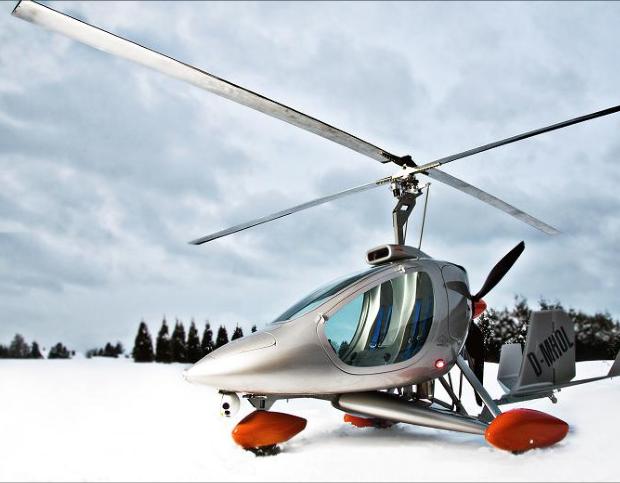

Seems RotorTec has a system that work.
Cloud Dancer from RotorTec

Rotortec had some really impressive results with the four blade rotors.
See Video
http://www.youtube.com/watch?v=iDbRR9mLLHk
As much as I know, they still plan to deliver the CD2 with the 4 Rotors as the standard configuration. But after changing from aluminum to carbon (due to the different resonance characteristics of the two materials) they are now in the process of redesigning/ adjusting the rotor head to deal with carbon. With the aluminum blades the CD2 delivered impressive climbing performance and smoothness. As the blades can be folded, even less hangar space is needed (the blades are shorter as well).
The owners of the already delivered CD2 have the choice to change to 4 blades once the certification have been granted. Hopefully I will fly 4 blade configurations soon (I have already flown the 2 blade carbon blades). Then I will be able to give feedback.
