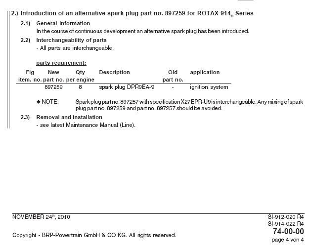

Page 4 of 4 speaks of an alternative spark plug for the ROTAX 914, normally DENSO X277EPR-U9, can be replaced by NGK DPR9EA-9. Has anyone used this alternative sparkplug. It seems it will be easier to obtain and possibly a little more affordable
Or am I reading the document incorrectly..
Document SI-912-020-R4 / SI-914-022-R4
Attached portion of relevant page:

I have been using the alternative NGK spark plugs , and they work just as well at a third of the price

Same here, no problem with the NGK Plugs.

thanks for the feedback, comforting to know that.... about to give them a go vhpy
