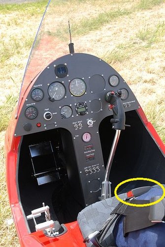

Aviation safety harnesses.
There have now been two confirmed instances where the pilot reported having difficulty (or was unable) to release the seat harness and escape from a burning gyro. (Douglas and Hartenbos airfield incidents)
In both cases "automotive style" seat harnesses were fitted to the two different makes of gyro. (Magni & MT-03)
Magni has responded with a replacement program for their older models which fitted with automotive type harnesses (until 2005). =D*
To the best of my knowledge Auto-Gyro MT-03 has not. ':- :evil:
What is more alarming is that some manufacturers who continue to fit non-aviation style harnesses to their aircraft. :evil:
Automotive style, plastic shrouded and or "push-button" release harnesses MAY NOT BE SAFE to use in aircraft. These are not designed for cars not aircraft and may fail to release when under load or fail when exposed to heat / flames.
Perhaps it's time to name and shame the manufactueres who have used / or ar still fitting these "automotive style" harnesses:

“The continued factory fitment of "automotive style" seat belt harnesses in some makes of gyros...
“ Minimum fuel pick-up level requirements...”
"automotive style" is not per aviation spec and is dangerous if you have an on-board fire. FACT
• The manufactures are aware of this but does not issue an AD to change.
• I have contacted CAA and they said that you are not allowed to change the safety belts to aviation ones if this does not come from manufacture.
• Manufactures tells you that safety belts are okay and you should not change it
NOW WHAT ?
