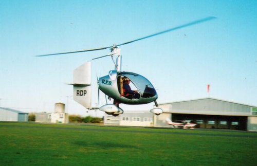

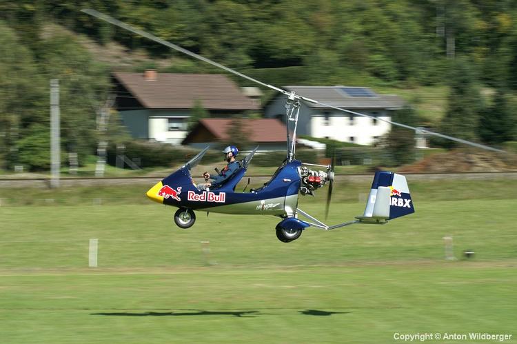

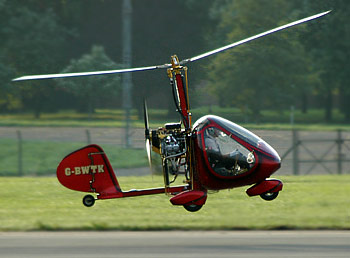

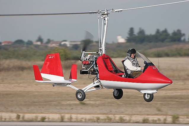

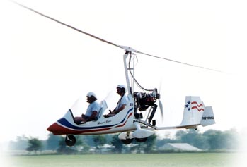

I certainly am not an expert, but have seen through the years in the engineering industry what stress does to many materials, especialy if it was a poor design for a particular application.
Having a look at coning angle's on the following aircraft during flight, all the coning angles look simular.
The photos might be deceiving, but the reality is, the advancing blade "bend" upwards and retreating blade has to give way, because of the rotor head design.
At wagtail, Johan has a gyro with well over 3000 hours, my conclusion is, have the rotors checked for safety reasons. What happened to the MT03 could be an isolated case. The aluminum manufactures could be to blame.
Just a thought, but time will teach us.
