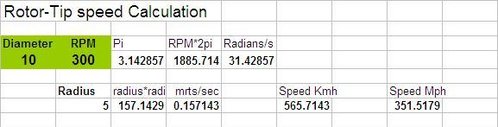

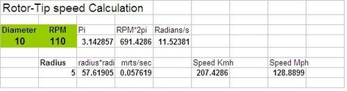

You are right Mak, blade-flap happens when the advancing blade (into wind) "flies" while the retreating blade (with wind) stalls.mak wrote: I am not a very experienced pilot, but I have never heard of a blade flap @ 300RPM. Usually we start to fly @ 300RPM. Can a blade flap happen @ 300RPM??
We know that a 10m rotor 'flies' at approx 110RPM (+120mph)
At 300RPM the tipspeed is + 350MPH - so unless you are standing on the ground in a 230MPH headwind the retreating blade won't stall - thus no blade-flap.
