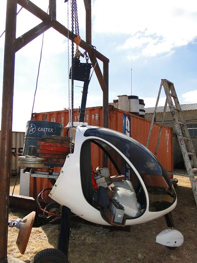

The gyro was loaded with concrete and tractor weights, when we ran out of weights, batterys :shock: and kunsmis :? had to do.
Total weight 1718kg

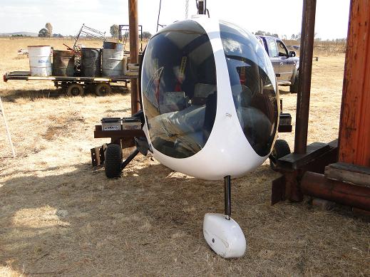

Standing with 1700kg, deflection between the wheels from no load to load was 50mm

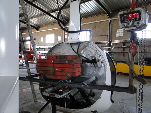

96Kg with 1M leverage from centre of engine mounting simulating engine torque

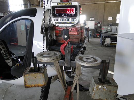

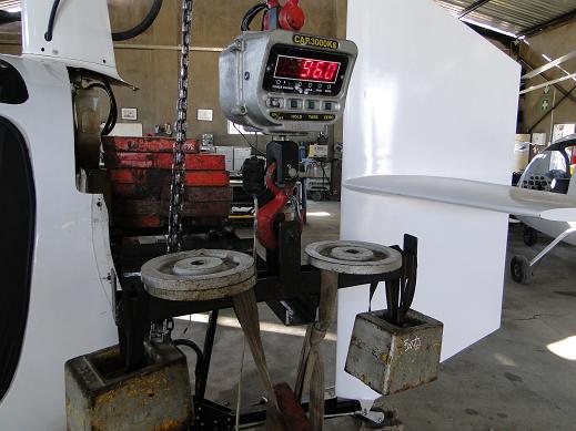

OzGyro wrote:Did I read correctly 1700Kg of load in the test and photo?
Yes, on the first photo you can actually see the pylon bending under the load and when the load was removed the pylon was back to it's original position and shape.

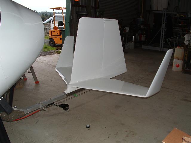

Gary Butlion send some pic's of the new tail development on the UFO, looks very good. Trust it will live up to the looks during the testing phase. Good luck to the UFO team!
