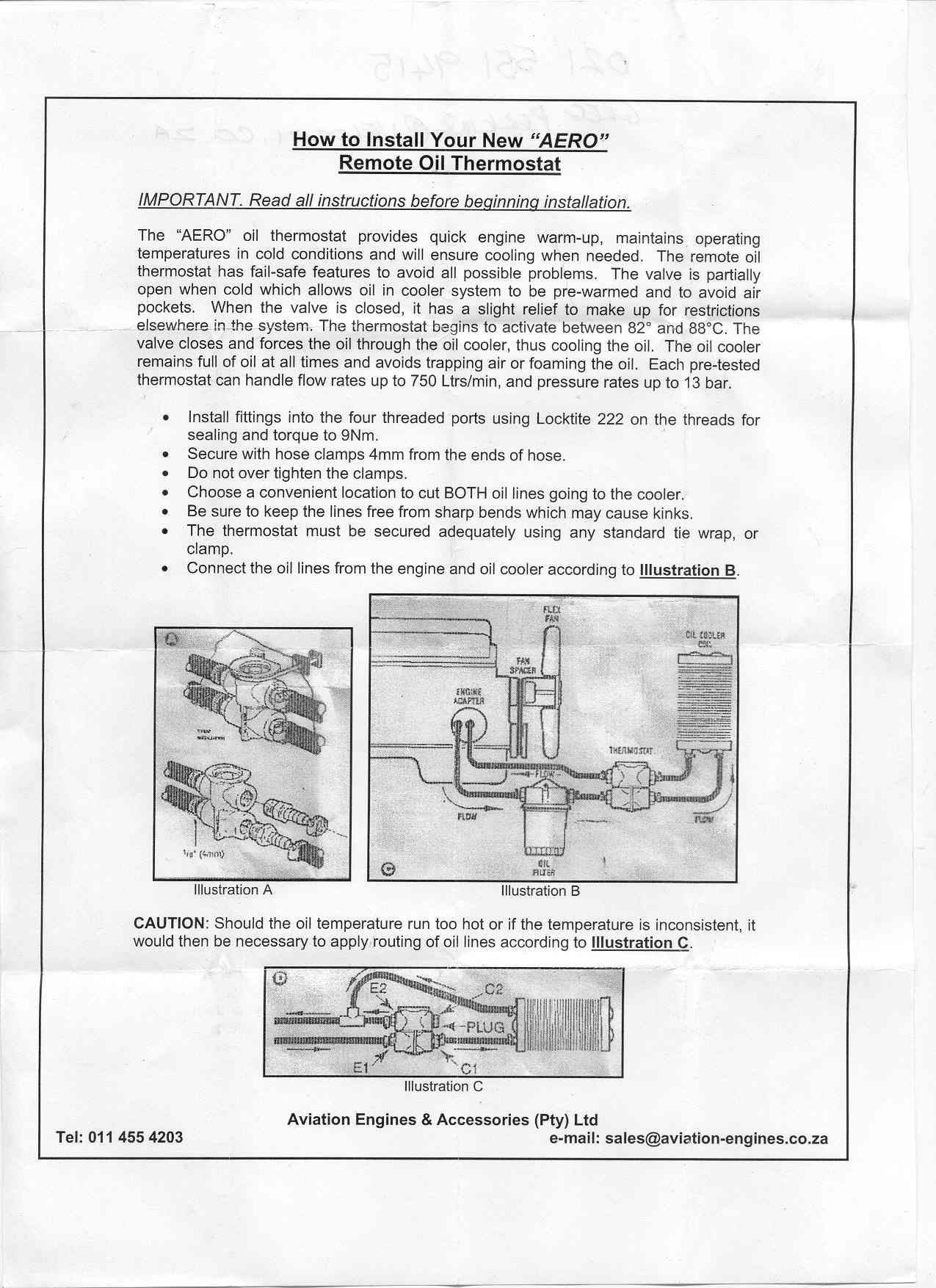

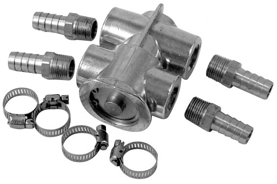

Re: Safety
The thermostat I use is not an all or nothing device, i.e. it doesn't have a totally open and a totally closed function
When it is cold, the thermostat allows a 90% bypass and 10% through the oil cooler. This would be the failed state. At fully open 95% is via the cooler and 5% is bypassed internally.
I too have never heard of any one of these ever failing. My normal operating temps are 90-95 deg C. You have up to a max of 140deg C . You will have enough time to heed your gauges and make a precautionary landing somewhere IMHO considering that the engine normally takes up to 15 minutes to heat oil up from ambient to 30deg C. In fact I have seen a 912UL installation on an old Thunderbird that didn't even have an oil cooler
