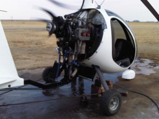

Hi Jeantree
Johan is happy with the progress, he says the UFO does 90mph with no effort. No funny behaviour like the submarine rudder it had on previously.
During a flight test on Wednesday afternoon, Johan did a power off landing, and had to use all left rudder to keep the gyro in a straight line, which
prove that we have some more work to do on the tail position.
Heat under the cowling is still a problem, we will give it some attention this week. The oil cooler will be moved to a position with more
airflow. The oil temp in cruise is 90 deg at current conditions, might be a problem in summer.

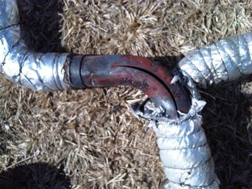

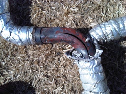

For everyone wanting to attempt what we have been up to with the UFO, here is a lesson to be learnt concerning heat
on the exhaust when a turbo is fitted.
I suppose JVL will be able to give the technical speech on what happens when you change from normaly aspirated to turbo charged on a
engine, to me it was a great learning curve. Now I have a better understanding why aircraft is very expensive... its called "DEVELOPMENT"
Long story short, new stainless steel pipes (ceramic coated) will be fitted at the end of this week, if all comes together as planned.
The two previous exhausts had a lifespan of 5-7 hours each, if the stainless steel exhaust fail, we will test inconell and afer that
titanuim and then heyns.
At least we have some options open for development
With all the trouble shooting we had, there is less trouble to discover
Watch this space, almost done

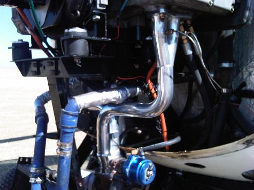

Everything came together on Saturday.
New exhaust fitted, made from stainless steel, ceramic coated to preserve the stainless and keep the heat where it
works best. We added heat deflectors, which is not on the photo below, all the cables, water and oil pipes stay
at a touchable temp. We are moving forward, I trust that anyone doing the same type conversion will learn
from our experience.
Next step would be a UFO conversion for Jan Ludolf who will give me a conversion shortly after he recieved his.
JvL is satisfied with the preformance of the UFO in flight, has flown 13 hours now. We will keep an eye on the
stainless exhaust, the working temp is between 800 and 850 deg celsuis, depending on the power setting.
Till next time
Fly safe
