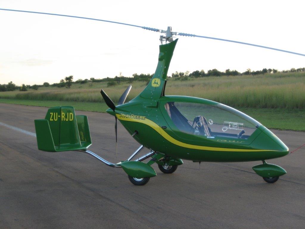

Yet another owner that decided what will work for him.
Think he will feel just as comfortable behind the stick as behind the wheel of his trusted green tractor.....
John Deere Calidus
Auto-Gyro Calidus ZU-RRG

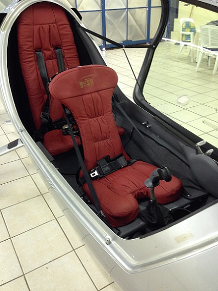

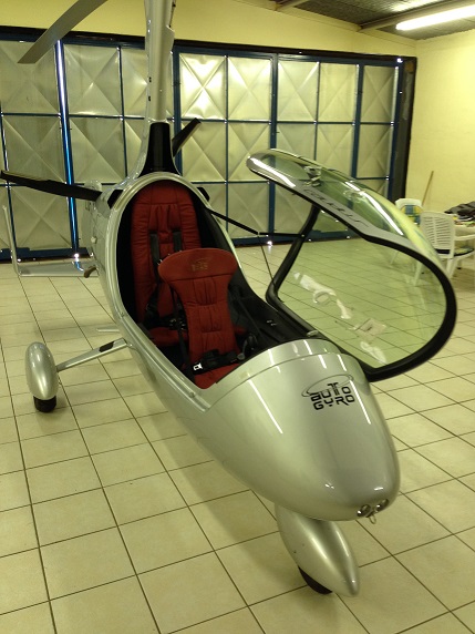

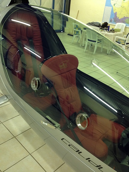

I have replaced the grey factory seat covers with red leather and added sculptured foam for comfort and back support. The factory should start doing this as a factory standard item. I have always fancied a silver sport car with red upholstery and as the Calidus is a sport car/ gyro due to its speed I had to go this route! I cannot wait for my first long cross country because you can get from A to B so much sooner than other gyros due to the speed of this machine. She is a looker in silver with red upholstery and a speedster at 100 mph cruise. Did I mention that she is also fast? :wink: (^^)
