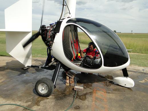

This last week was one of those ones that produced more challenges than anticipated. The EJ25 engine did not
last long with the turbo. Oil leak on the head gasket was causing the oil temp to rise beyond normal operating temperatures.
Seems Johan always has something up his sleeve, when I arrived at Wagtail Friday afternoon, he had fitted a 2l Subaru 16 valve. These engine's
came standard with a turbo fitted on the production models.

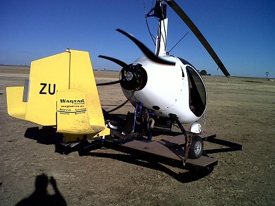

During the Static thrust test, performance was excellent. The EJ25 (normaly aspirated) produced 237kg, and the 2L was pushing 303kg under 5000rpm (**)
The boost was only 0.5 bar.
The weight to thrust ratio: all up weight 650kg and thrust 300kg = 2.16:1 (^^) (^^)
According to Johan a ratio of 5:2 (weight to thrust) is normal on some gyrocopters.
Johan will continue with the engine management settings and test flights during the week.
I highly appreciate Johan's time and effort to make this project a success.

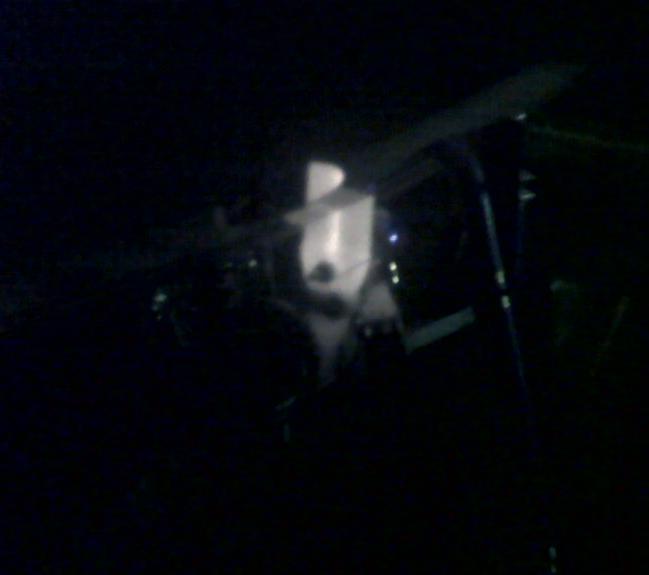

FLYNOTE wrote: Get that ufo to gariep what ever you do. Modling wont give up until your smile is bigger than his !
Modling is pushing hard to get the UFO ready, and I am not sure who has the widest smile, the results with the 2L is unbelieveable.
If all go according to plan the UFO will take to the sky this afternoon (^^)

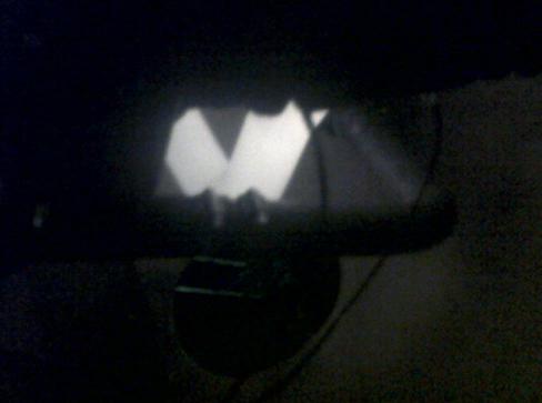

Glowing hot exhaust inside the cowling
Exhaust 1.JPG (12.82 KiB) Viewed 4285 times

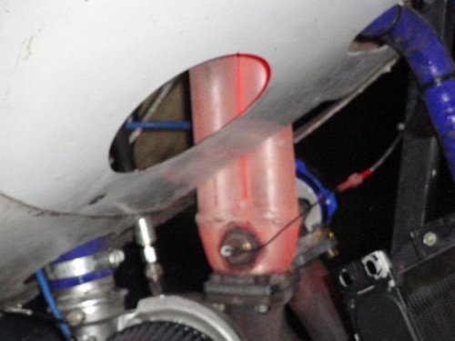

I think this is what you wanted to show, really red hot exhaust stack. The turbine housing was actually also Cherry red in colour, but the picture was taken after we already came back on the power so only the exhaust pipes are still pink in colour.....
And then.........the exhaust manifold split open along the seam........and this was on a VERY expensive imported branch...imported stuff is not always better than our own local stuff....now we will go for the stock standard South African BOSAL pipes...

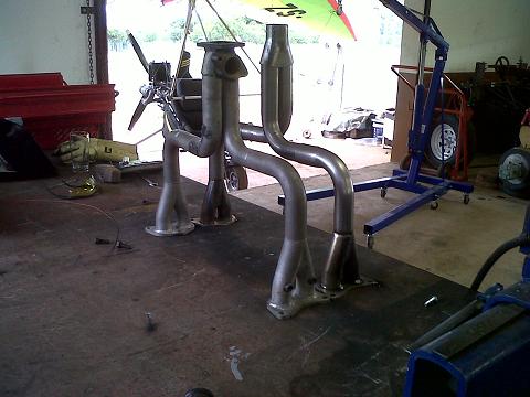

The exhaust is coming on fine, will have it ready for Monday when Johan is back from the north.
I discovered there is more to an exhaust that meets the eye, thanks to Bert de Graaf in Pretoria. We will have to
make up some goodies to support the exhaust while it is cherry red and vibrating during normal operating conditions.
Watch this space, we are getting there (^^) (^^)
Pierre
Exhaust Amper klaar.JPG (31.49 KiB) Viewed 4151 times

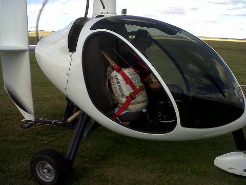

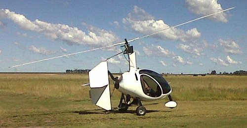

With water and oil temperatures under control, we had some progress in the right direction.
Johan flew it, then loaded some weight until he had an extra 80kg, to simulate a pax. The gyro became more unstable as it got heavier during flight.
With the last landing, it was quite visible there was a wrestling match with the controls.
This is where the 685kg came in, the gyro+80kg popcorn+Johan=685kg.
The other problem was, it was not possible to catch the nose on the take off run before the tail wheel
touched the ground. Same with the landing, tail on the ground first, then the main wheels.
Another disadvantage was, the tail wheel forced directional control, rudder had very little influence as long as
the tail wheel was in contact with the ground.
The end result, Sycamore tail was fitted, new telescopic cables for rudder control and 15kg in the nose to get 5° nose down
position during the hang test. While this was happening, duel controls was fitted as well. Tail wheel clearance has improved significantly.
With the first test, the prop wash just pushed the tail to the left and the gyro ran of the runway to the right (**) . After setting the
rudder position, the ground run was a lot better, but we needed more adjustment on the cable.
Johan will test fly the UFO today, and hopefully we will know soon what the result of the tail modification has install.
Will post some pictures with the Sycamore tail later.
Loaded with mielies.
UFO 2.JPG (28.73 KiB) Viewed 3822 times
Tail wheel draging along

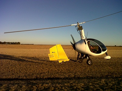

Postby MPL Pilot » Sun Jun 12, 2011 8:02 am
With the Gariep flyin, the UFO had to fall in the back of the que.
MPL Pilot wrote:With the first test, the prop wash just pushed the tail to the left and the gyro ran of the runway to the right . After setting the
The test flight had similar results as the previous time. Not enough left rudder :?
Johan and myself had a test jig made to simulate rudder control during static runs.
After the first test run, Johan knew exactly what the problem was with the rudder, 300kg prop wash over the rudder
was at work with negative results.
We changed the tail angle with 10 deg to the left, and had positive results on the test jig.
Now he had constant control from a low to high power setting with left and right rudder. (^^)
Back on the runway, the effort of the test jig was worth the wait. On the second run Johan was satisfied with the
UFO's behaviour and took to the sky. (^^) (^^) (^^)
We did some fine tuning on the cables ect. during test flights.
There might just be a surprise at the Allday flyin.
Die enigste ding met die UFO, soos Flynote verwys het na Mak. Die UFO lyk nou soos n "dik gevrete eend"
wat n skop op die g@t gehad het. :lol: :lol:
Johan can give some insight on the results of the test flights, it will be good to hear that detail from the man himself.
UFO on the test Jig
UFO getting airborne for the first time with a Sycamore tail.
UFO 1.jpg (51.86 KiB) Viewed 3612 times
