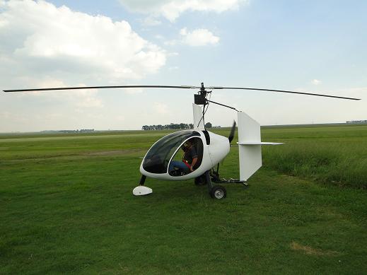

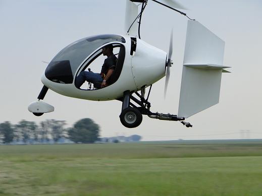

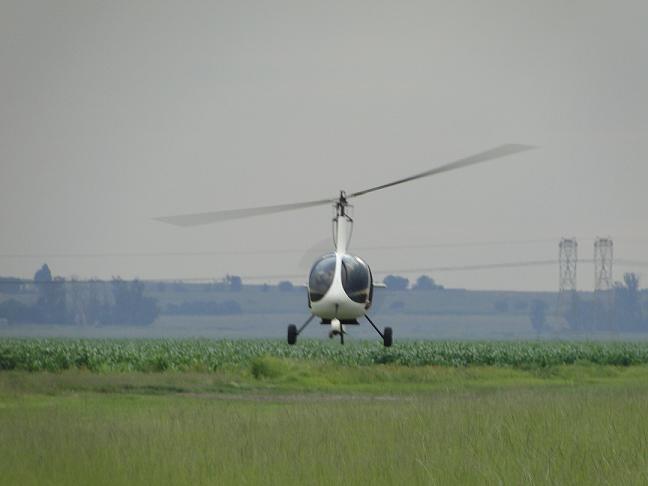

You are right (^^) (^^) Now we can start a new topic "Flying the UFO"
Yesterday, the conditions was perfect for test flying puff
I will post a video on you tube soon.
We have a little more work to do on the UFO, we are getting there.
The lenth of the rotors make the under carriage look short
First take off for the year
Awsome!!!

fransstrydom wrote:I dont quite follow.Is it mealies in the back ground?.The scenery looks different to me.The second photo looks like the road leading to the house or the runway intersection.Looks to me like the whole runway washed away on the last photo.Are these photos after the last heavy rains?Can see the pylons very faintly in the background.
What are your immediate perceptions of the alien?
Frans, jy vra so baie vrae wat my laat dink aan die manier wat jy daai gyro van jou land, so baie gebeur op een slag, dit lyk elke keer soos n noodlanding (**)
Dis lekker om vir n jou been te trek. vhpy vhpy
Al die foto's is by Wagtail geneem, behalwe die eerste UFO foto wat Johan gepost het wat in New Zeeland geneem is, toe hy die UFO daar gevlieg het.
Wat Gariep betref, Johan von Ludwigh is vol vertroue die UFO sal daar te siene wees, dis nou kleinighede wat aandag nodig het, die grootse is die conversion na die UFO toe.
Dinge wat nou aandag kry is die volgende:
a) Die UFO vlieg effens neus links in die wind, trim op die rudder sal dit regmaak.
b) Daar is nie n groot verskil tussen 4900rpm en 5400rpm met thrust gedurende vlug.
c) Nie genoeg krag om 2 op te vlieg op ons altitude, n klein wind pompie sal b en c regkry.
d) Olie temp is 110 grade gedurende vlug, olie verkoeler is die antwoord wat in elkgeval die windpomp vergesel.
e) Wind spoed meter moet vervang word.
Al die ander mods wat gedoen was met die pedale en beheerstok ens, is suksesvol.
Amper klaar ##
Veilig vlieg

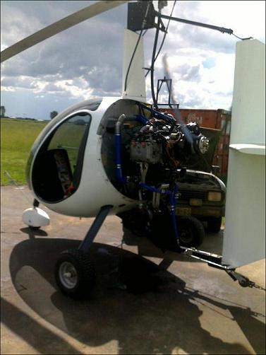

I received the registration marks for the UFO today. (^^) (^^)
Spoke to Jan at Wagtail yesterday, after he pulled my leg, saying nothing had happened on the UFO yet, and I must mention, he had Frans Strydom for a witness :evil:
he laughed and said, "got you again!!"
To my relieve, everything concerning the turbo modification was fitted. Now just awaiting the waste gate, (Jaco organised) which is last to be fitted.
Johan wants to get the preliminary proving hours done so that we can continue with my conversion to the UFO, to fly the balance of the hours, before he signs it out.
Looking forward to good weather and only success (^^) (^^) (^^)
Will post pics in the next week.

Postby MPL Pilot » Thu Mar 03, 2011 6:11 pm
Johan send this pic of the turbo instalation, little dark but you can see the oil cooler pipes
and the tube going up to the intake manifold at the top.
UFO on the test bench, checking for oil leaks, ect...
