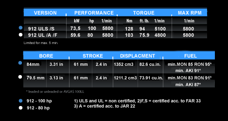

Die krag om jou uit die moeilikheid uit te kry le in die Torque van die engine en nie die Kw nie.
Kyk die verskil tussen die Subaru en die Rotax
The 2.5-litre
engine delivers a powerful 126kW of power at 6,000rpm and 229Nm
of torque at 4,400rpm.

If your turbo does not engage on a 914 then you have a 912 ul which is 80 hp. The 618 's power to weight ratio is a lot higher than your 912 with the dead weight of the turbo.
You have lost 35 horses of 115
I agree with your rotor management principle and airmanship

Ebie, not wanting to get on your back, but the way I read it it sounds as if Torque is the important one and not Hp. ...this is not really true. Hp is the important number not torque....now while everybody sits up straight let me explain.
The formula to convert torque to horsepower is :(Torque X RPM) / 5252 = Horsepower.
Physics : Torque is a force, just like weight.
Hp is energy. Forces can be multiplied, devided split....
Energy can be converted, fuel to Hp, nuclear to heat to electricity and so on.
For a gyro to climb, it increases it's POTENTIAL energy ( it gets higher and higher ). Energy can be converted, never "created" or destroyed, so to climb you need to convert something :
Fuel converted into heat, converted into linear motion ( piston ) transfered to circular motion ( crankshaft ) converted to thrust by the prop accelerating a certain mass of air and so on.
Bottom line, it is the energy that gets you out of the tight spot, not the torque.
There is an old saying that you need torque to swing a big prop....no, not COMPLETELY true. with 0.00001Nm I can swing a 12 m prop...just very slow, but with 10 000 Hp I can swing that same prop and make a lot of wind......just tell me what the diameter is, I calculate the tip speed and then I calculate the RATIO of the gearbox to give the required tip speed......
The gearbox ratio will ultimately determine the torque transferred to the prop.
Luckely the Subaru has the Hp based on the torque and the fact that that torque is available at 5000 + rpm.
