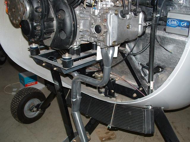

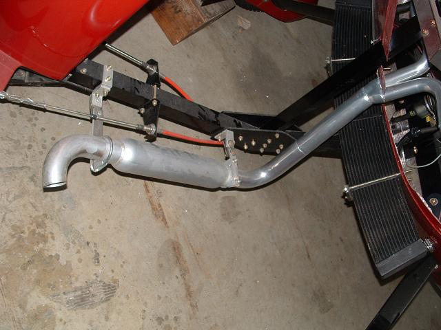

Today we tested the free fow exhaust, during the static test we got 235kg on the scale instead of the 218kg with the standard exhaust. (The engine sounded like a dragster at Talton). Other tests included, removing wireing from the engine and at last everything except for ignition, eventualy the EJ25 pumped black smoke thru the exhaust with the choke on, and registered 5100rpm during the worst of conditions. Good enough to keep the gyro flying.
Geoff Price from the UFO company in NZ send some pic's of the exhaust they developed for the UFO, it delivered 20hp more than the standard exhaust. The cost would be (seramic coated in and outside) R3200 + freight.
Next would be to setup the engine management system with the help of Kallie Venter.
Here is two of the pic's Geoff sent.
