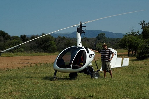

I was there this morning and I saw it with my own two eyes
You aint seen no gyro till you've seen this one. You have to double take at first and then pinch yourself
It is a monster
It has space inside the bubble for an entire family.
The engine is a brute that growls at the pisswillie rattaxes. It takes a healthy gulp of fuel and then gobbles up the runway and storms into the skies like a bird of prey in search of other birds to ... Wat is verslind tog in Engels?
Pierre, you have a very lekka gyro there. Well done on two years of sweat and I'm sure a few tears but hell, its worth it hey!!
Enjoy your great one of a kind gyro and we' ll see her strutting her feathers at ... Where is the gyro jamboree again next year?

Finaly, the UFO has flown its maiden voyage home.
We did endurance flights this last week and double checked preformance, fuel consumption, rate of climb
and the reliability of the last 18 months modifications.
These stats have been recorded during test flights.
Fuel consumption has been 31l at 70mph at 4250rpm.
EGT at 840 deg cel during cruise.
Oil pressure 4 bar
Water temp 82 deg
Oil temp 80 deg.
Boost 1 Kpa at 4250 rpm.
Air intake temp 50 deg at 4250 rpm
To me as a rookie gyro pilot, it is scary to use full power at take off, at 5000 rpm, the UFO climb
of the deck like a trike, and if I am not back on the stick quick when she lifts of the ground, she reach
90mph in a couple of seconds.
Johan, having flown every gyro available says the UFO has simular characteristics as the Xenon in flight, in thermals or gusting conditions she need some correction.
It is great to be flying again, and must thank shallow pig and scary pilot for escourting me from Wagtail to Hartbeespoort.
To the Wagtail team, this is a job well done! Thank you.

It good to hear from you again Nic.
Good question, I most likely would have carried on anyway. You know what it is like, the adventure and challenge
of the project was inviting, I could not resist. The UFO was under dust ect. The thought that this thing can actually fly.
What I did not know, was the engine was under powered for our altitude and hot conditions. It could have flown earlier if we had more knowlage of all the requirements that had to be met to get a Subaru 2L turbo to be relaiable.
Now she flies like a love sick angel, and it is really wonderfull to experience every take off and landing!!
Everyone was great on this project, from the previous owner (Gary Butlion), Geoff at Acorn Industries in NZ to the Wagtail
team. Not to mention Braam Hechter, Claus and all the other guys that gave their cooperation at SACAA. Then the fellow pilots on the forum, some had some valid questions and encouragement, all had a input in some way.
I should thank you as well, you almost talked me out of it, few salesmen are as honest as you were.
I am truly greatefull to be part of this small group of pilots.
