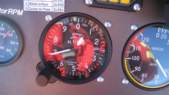

Attached is a photo of my gyro at 10 700feet. You can see the rotor RPM on the left of the photo at 370 RPM. I would imagine the rotor RPM would have increased slightly to about 380RPM if I accelerated to 90-95mph (my normal cruise speed), so I think I am correct in saying that rotor RPM does increase slightly with altitude, but not by much.
t-bird, the ELA figures you give are about the same as what I get on my machine. At the end of the day, the performance of any aircraft is directly proportion to its weight if using a similar wing profile.

I will check next flight but I am sure my rotor rpm does not drop by as much as 10% when I go into a power-on hover. (320-32=288 - nada) Dont think I have ever seen it below 320. Logically it should drop yes but cant say that I have noticed a marked drop and I often pull the nose up into a hover with power on. (obviously not full power) Does reduce the rate of descent significantly.
