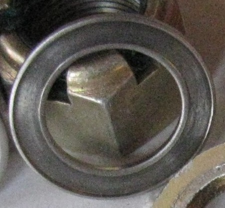

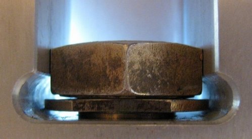

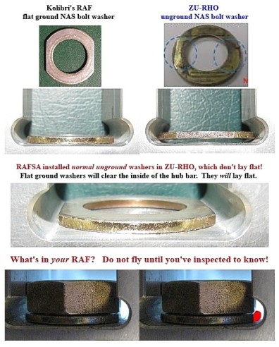

I've reposted below two public safety photos, so that RAF owners may easily confirm for themselves if their hub bar contains the correct washer (with flat grinds) vs. those installed by RAFSA on ZU-RHO. (One wonders why such photos are not on the manufacturer's own website.)
I applaud Francois's posts and continuing efforts in the matter of the ZU-RHO crash.
The strength, however, of the NAS RAF bolt vs. the older AN12-34 bolt is almost moot.

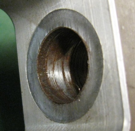

The REAL ISSUE is the jointed hub bar/winglet, which is vulnerable to constant lead/lag bending forces.
I am unaware of any other gyro which contains two-part hub bars with huge cutouts and tensile bolts.
Any disassembled RAF "joint" will show evidence of fretting, and the bolt holes will become ovoid in time (as did mine after only 234 hours). Don't believe me? Take apart yours and see for yourself.
Whether the bolt was AN or NAS is almost immaterial.
Bolts are made to resist only two primary forces: tensile or shear.
They are not made to resist vigorous forces of cyclical bending, especially in all directions (horizontal, and coning).
What the rest of you RAF owners fly with is your choice, but you're fortunate to have a choice other than the OEM rotor system.
I've "stayed away" from RAF's rotor system. So has Peter Goldsmith.Is there still something bothering me at the back of my mind when I fly, even now that I know that RHO’s bolt failure was due to gross negligence? YES – for my own peace of mind, I need to know the margins involved both in the design and the assembly. Without that knowledge you have two choices, you either trust Rafsa unconditionally or you stay away. Your choice.

Kolibri, Kolibri, Kolibri… You are at it again! Thank you for reposting the washer pics. Thank you for sending me the PDF backups of the deleted threads as well – it is useful for the record. (Very efficient of you, I might say.) If anybody should be interested in it, it is available. Incomplete public records makes for ‘darkness’. MODERATED

It's a hinge. The internal faces of the hub bar and winglets move against each other.
Pictures of both ZU-RHO and my own RAF have proven that with the blackened fretting evidence.
Furthermore, the parts move around the big bolt, ovalizing the hole. Great.
Finally, if none of that is enough of an eye-opener, with the castellated nut, the owner cannot verify proper torque.
Pre- and post-flight inspections will confirm only that the big bolts are still there, and nothing more.
How loose the assembly becomes over time cannot be reliably discerned by the owner.

Ah, but the "set clamping force" cannot help but decrease. Here's why (and I've posted photos as evidence):If none of the components of the joint have ever gone beyond it’s yield point, as should be the case for a well engineered design/assembly, there is no reason for the set clamping force to change.
The OEM parts are wearing themselves, thus increasing play and decreasing bolt tension.
The washers (bolt head and nut) are compressing the aluminum faces, which also decreases bolt tension.
Once that bolt tension has been sufficiently reduced, the lead/lag bending forces have much more effect on the bolt head.
In the two cases that we know of, the bolt head was "bottle-opener" popped off, vs. the threads failing.
Meaning, the bolt did not live up to its tensile specs (which are based on the weakest part, the threads).
The bolt failed because it's being used inappropriately (in bending loads), and the tensile specs don't account for that.

Below are photos of my RAF hub bar after 234 hours with deeply compressed nut washer and winglet faces.
(One of the steel nut washers had been greatly compressed, forming a 4+mil "race-track" underneath the nut.)
Total compression was at least 10 thousandths.
Ten thousandths. That's about the thickness of 2½ sheets of copy paper.
Assuming my RAF hub bar had been properly torqued by RAF Canada to the second castlellation (and thus 180-200 ft/lbs), after 234 hours of flight the aluminum parts and steel washers had been compressed by a total of at least 10mil.
Effectively, through parts compression, the bolt torque was reduced one castlellation in tightening, i.e., from the factory 2nd castlellation to the 1st. The difference between those two, according to Francois, is 140 Nm or 103 ft/lbs. Instead of flying with about 177 ft/lbs, I was (before replacing it for Sport Copter's system) flying with no more than about 74 ft/lbs, which was only 42% of the factory setting.
My RAF parts had been so compressed, that I was effectively flying on the 1st castlellation of tightening past snug, not the 2nd. And how was I to know that I'd needed to tighten by as much as a castlellation to make up for the parts compression?
Are you all now getting the picture? Are you finally wondering what actual torque is today keeping your RAF hub bar/winglets together? One thing is for certain: it's no longer the factory setting of 180 ft/lbs (~240 Nm), because your parts have been compressed!
And that's the problem with the castlellated nut; it doesn't lend itself to maintaining a consistent 180 ft/lbs with squished parts under such vigorous gyro flight dynamics. A regular Nyloc nut, however, could at least be periodically checked for proper torque.
The bolt head in ZU-RHO popped off in <50 hours, because of being greatly undertorqued due to that oversized washer being squeezed inside the hub bar cut-out. Its actual compression on the entire joint was no doubt far less than my 80 ft/lbs after 234 hours.
