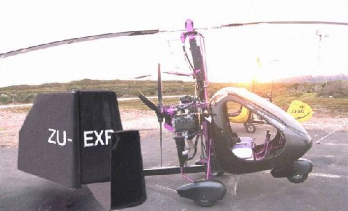

I thought that I had successfully put the debate to bed in 2009 when I attached a pic of the H Stab I had affixed to my RAF and opined that, in my view, it severely hampered the flight characteristics of my untamed beast. For those who did not follow the fourteenth (I think) thread on the subject, I have taken the liberty of reattaching the pic. RAF's and H Stabs are like oil and water, they just don't mix, so please leave all my stabless RAF mates alone and pick on someone else.
