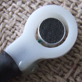

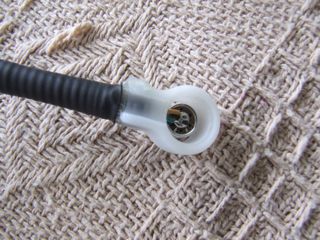

Jean, the air dam does perform very well, the solution to wind noise is mechanical and not electronic, although this does help. The microphone mounting is critical to the noise transfer from wind and other mechanical noise that can get in to the system. I have yet to see a headset that is made for high wind that works properly especially with VOX and ANR. The other factor is the audio power supply is from the Rattex and through a heap of other noise generating devices such as fuel pumps, GPS switch mode power supplies etc. For info i attach a picture of our microphone mounting and you can see that it is isolated from the boom. If you review the back it has a slot and a large chamber, this is to increase the noise on the reverse of the microphone and help the noise canceling section of the element perform. The slot is to remove the "coke bottle effect" of wind across the back of the boom when turning the head. It really works well in trikes and helicopters ground crews.
See the slot for coke bottle effect
mic boom1.jpg (28.86 KiB) Viewed 3319 times
Front element is flush with housing

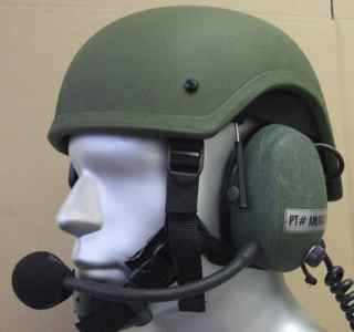

Similar in finish..
Condor and sets.jpg (8.41 KiB) Viewed 2967 times
Thanks Len, as you have all those radios available, seems like the best option, i would imagine the noise will be the same in all machines. Closed cockpits are not really an interest at this stage. But the rear of a Gyro is the problem area. I have made some in military green (as we are making a military project at present) with new amplifiers at 1/2 phase similar to a chatterbox series. Just confirm they are twin jack. I will test fly with a stand alone sigtronics intercom in a trike first though this week. Then will get them off to you to play with. When complete we can send to Springs and wherever for evaluation. These units are designed for the Condor helmet so makes sense.
see the military version...
Thanks Paul
