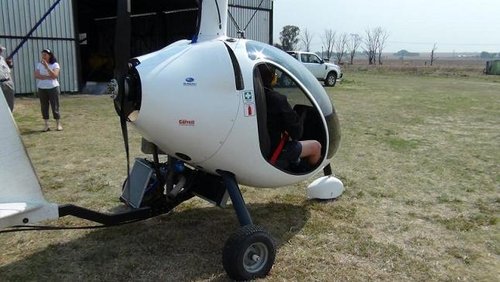

We had a busy week at Wagtail. After more test flights, Johan was satisfied with UFO's performance, exhaust etc. With daily temperature
rising so did the water temp. Replaced a water radiator with a larger one, now the water temp is 88 deg at full power.
EGT in cruise 940°C. Oil temp stay around 80°C.
It is really an experience flying in the UFO, after two years of dreaming and hoping this day
would be a reality. Now it is time for celebration
I have done a couple of circuits with Johan in the co-pilots seat, then Jan Ludolf took the co-pilots seat which would help
me when we start the conversion.
When it comes to fuel consumption, it has been difficult getting exact readings, because of the
diverse tests, static runs, rate of climb, etc. Initially I calculated 35l/h, but during the test flights
with Johan fuel consumption dropped to ±22l/h
I am still confused with the results, but time will tell.
Performance, that is a discussion on its own... The horses delivered by the Subaru 2l turbo
is an experience. During climb at full power the under carriage moves to the right, it is hard to describe the
feeling and it is not possible to correct during full power. Once at 75% power, behavior in normal.
Soon the UFO will be at flyins, proving hours need to be completed and then the conversion.

Proving Hours is just about completed, We want to make n small mod to the front
wheel before the paperwork gets done.
Small things that changed lately.
We moved the trim button close to the throttle, it used to be overhead.
Omni fuel was installed, calibration in the final stages.
I would like to thank everybody for the support and valueable insights we have recieved
since we started with this project, has been tough at times and thought it was all in vain
at other times, but we had break thru moments as well, which kept us motivated.
It was worth the wait for this result.
Fly safe
Pierre

Hi all
We checked the boost on the turbo yesterday, since the UFO didn't have a rate of climb as it should. For some
obscure reason the boost dropped to 1.1 under full throttle
Back on the test bench, Johan turned the boost up to be 1.4 at full power. To see the result I joined as co-pilot
As we gained speed on the runway, checking the airspeed and boost as Johan was opening the throttle slowly, all of a sudden
at 60 mph with just the right engine rpm, the boost went up to 1.65
the engine revs up to who knows what
It was the first time I felt how a almost 700kg gyro get airborne like a trike with a 582 Rotax
All the time the gyro was stable, nothing funny except the rate of climb.
The end result was, 4700rpm with 1.2 boost during the static run translates to 5500rpm and 1.4 boost
at full power.
Then we changed the three blade prop to a two blade (also IVO), same power setting as above. With that configuration the UFO would make a
very nice hovercraft. Just does not want to gain height.
Changed everything back to the first configuration again, went for the test flight.
The next stage is the Wagtail rotor head and pre-rotator system to be fitted, should be done before
the end of November.
Fly safe
at full power.
Fly safe
