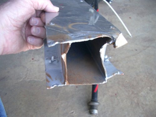

What does concern me is how easily the mast broke, where it broke and how thin the "webs" are in this double "H" section. The mast broke off at the first attachment point to the body. This is some 30mm below the cowling. There is no damage at all to the surrounding glassfibre cowling.
I have given this section of the mast to Braam who will have it inspected by a Fracture Mechanic.

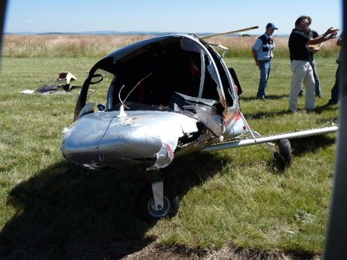

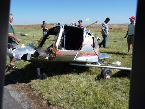

Some sad images.....
