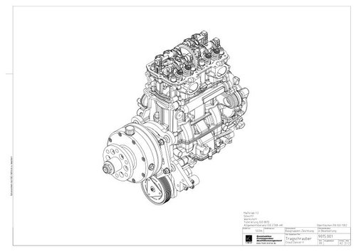

We have promissed Updates to the project but it made us very bussy over the last. We will finalise the Gyro
by beginning of the year 2010 and so fahr (Okt 2009) we have the recieved the "Provicinal Certificat of Airworthiness" from
the German Dep. of Aviation.
See encolsed a Drawing of the new Rotortec Powerplant 135 Hp with direct Planatery Drive. Powering a 1800mm Prop
at top speed of 1920 rpm for low noise.

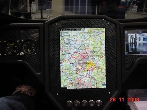

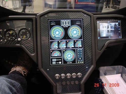

Re: news of cloud dancer II
Small Update.... The new "2 in one" Glass Panal for the Cloud Dancer II
Size 10,4" Tutch Screen , High Britness Display
John
John
