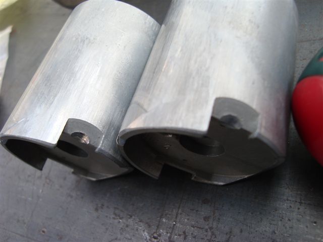

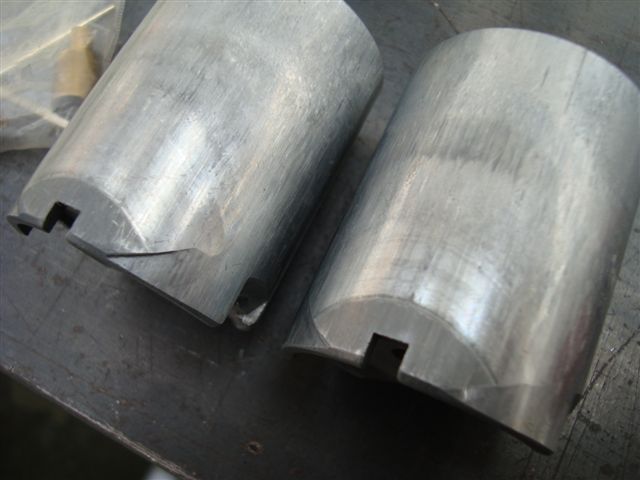

Graham Mac
Posts: 374
Joined: Wed Nov 09, 2005 4:46 am
Location: gauteng panorama
Re: 582 bing carbs overflowing
Postby Graham Mac » Sat Feb 21, 2009 5:04 pm
[attachment=1]DSC01819.JPG[/attachmen
Note the wear on the slide pistons and the indentation on the air screw setting area
Thats the reason for overflowing
causing rough idle and unseating needle and seats
thanks to all for your input and help
tandemtod1
Posts: 63
Joined: Wed Oct 22, 2008 3:06 pm
Postby tandemtod1 » Sun Feb 22, 2009 5:53 pm
Thats some seious wear, I don't remember ever seeing slides as bad as that. I am sure that that is causing a very rough idle and when you replace them your problem will be solved.
Well spotted.
