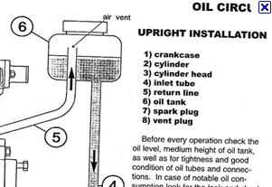

I'll add this pic again - please make sure your reservoir is on the right way, or else oil will never drain to where it is needed.
Oil bottle.JPG (14.9 KiB) Viewed 1246 times

Alkemac wrote:I'll add this pic again - please make sure your reservoir is on the right way, or else oil will never drain to where it is needed.
Hi I will check this on Sat, but whats the symptoms if its on the wrong way, will it be same as mine i.e. level dropping?

Postby Alkemac » Fri Jan 04, 2013 11:28 am
Kind of thinking two along lines at the moment.
If the bottel was the wrong way, where the lubricant is pumped back into the reservoir, the lubricant could seep back into the mechanissm, or, stay static, but never get into the down pipe unless you filled above the minimum level, but then only that amount would enter the mechanism.
Start off by checking the placing of the reservoir.
