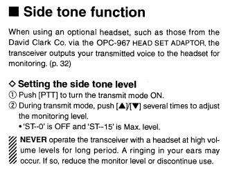

More importantly this radio is fitted with a ST (adjustable side tone feature). If set incorrectly and its obvious that most are because when we receive them they are set to default "6". This is a feature which allows the volume of the audio from the headsets to be adjusted which allows you to hear your own voice on transmission. When these little radios are used with intercoms this can cause a feedback "loop" and will give you a nice whistle when you transmit. Please check this before you fly again and see that its about 1 or 2.
See attached cutting from the Ica 5 manual on how to do it.

It has the same adjustable ST feature as above and please adjust as per attached cutting from the manual. If you have problems with them working with a older style intercom, I am doing a service for a minimal charge of R50,00 (ex works) to change the software to allow them to work.

This is a good piece of kit, however it has the same ST (called headphone level) and is default on Menu Number 24 to value 6, adjust to say 1 or 2.

So chaps please take a look at the side tone and if maladjusted will drastically improve the transmission out with no decrease in performance.
